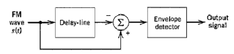

Hi all.
Consider the following demodulator:
[itex]s(t)=A_c\cos[2\pi f_ct+\beta \sin(2\pi f_mt)][/itex] , [itex]\beta<1[/itex].
The delay line causes π/2 radians delay in phase. The problem is to find the output signal of the demodulator under the following assumptions:
[itex]\cos(2\pi f_mT)\approx 1[/itex]
[itex]\sin(2\pi f_mT)\approx 2\pi f_mT[/itex]
T is the delay in time caused by the delay line which leads to π/2 radians delay in phase.
It's not a homework, although once it was! What is the simplest way to solve this?
Thanks in advance.

I think maybe this means [itex]f_m/f_c\ll 1[/itex].

This a viable detector. I've seen it used, though not recently.
Consider that the delay line is 1/4 wave, hence delays by 90 deg at fo.
The governing equation is similar to:
sin(x)cos(x) = 1/2 sin(2x). Thus, the baseband result is 0.
As the frequency varies from fo, the resulting phase shift either increases or decreases resulting in a +/- baseband signal as the vector sum of the shifted signal contains either +a sin(x) or -a sin(x) depending on the deflection, a, and relative frequency shift, + or -.

I think the assumptions say that T is small enough so that we can take s(t)-s(t-T)≈s'(t)T.
So the input of the envelope detector is:
[tex]-TA_c \left (2\pi f_c+\frac{\beta}{2\pi f_m}\cos(2\pi f_mt) \right )\sin(2\pi f_ct+\beta\sin(2\pi f_mt) )[/tex]
And the output is:
[tex]-TA_c \left (2\pi f_c+\frac{\beta}{2\pi f_m}\cos(2\pi f_mt) \right )[/tex]

Does this scheme have a name? You are citing assumptions, so I think you should be able to cite the method's name. Is it from a textbook? Author? Title? If it's only in class notes, can you photocopy the relevant half-page explanation and post it so that those who may be interested can take a look at it?
It looks like a type of 'slope detector', to me and is the easiest way to detect fm with a simple AM receiver - just off tune it so that the received carrier frequency is half way down one of the skirts of the IF filter. Crude but effective and, of course, will only give a linear response for relatively low deviation FM.

The problem with using a simple temporal filter, as suggested, is that its response is periodic for ever. A good old lumped component resonator works only over a limited frequency range and you can get a 'fast slope', which will discriminate a small frequency deviation.
The quarter wave delay must, surely, refer to the wavelength of the carrier and not to the modulation. It's always much easier to think of what goes on when you have a high deviation (wrt the modulating frequency) because it is possible just to consider the carrier 'sweeping up and down' over the discriminator slope and rely on the fact that the modulation sidebands (although infinite, in theory) all lie comfortably within the span of the filter. If the modulating frequency is not low compared with the carrier (small fractional bandwidth) then it becomes a bit of a nightmare due to the folding back of the lower sidebands which could fall below Zero Hz.
This was onced used in exceptional quality FM tuners. IF frequency was knocked down to a few MHz, and the delay was a long, thin coaxial cable that was spireled up in a 4" diameter x 1" high sheild can. The output was beat against the original signal in a fairly common mixer chip and the output was the demodulated signal.
Using a glass or quartz delay line, one should be able to fit this technology in just a few square inches.
