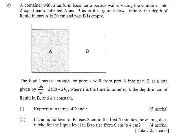

Solving Differential Equations to 2 ln |20-2h| = kt + c
1 reply · 1K views · last reply
kyu
-2 ln |20-2h| = kt + c
kinda lost. solving (i) would be enough for me
  • Diagram of a rectangular container with a uniform base divided by a dashed vertical porous wall into two equal parts labelled A and B; the liquid fills the left part A to a level below the top, and part B is empty. Printed problem text above and below the figure.
The first part of the question is asking you to solve the separable differential equation. It looks like your solution is fine to me. Except you need to re-arrange it a bit. Solve for ##h(t)##.
The second part of the question is 'hinting' at an initial condition. In particular: ##h(5) = 2##. So what does that tell you about the rest of the information?
