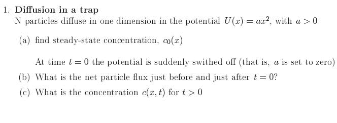

2. The attempt at a solution
a) The steady state concentration is the concentration when t --> infitine, right? How can I find that when I don't know c(x, 0)?
You have two fluxes, one due to diffusion, the other due to the potential. In steady state, these cancel each other. So try writing those equations down and solving them.
Flux due to diffusion = [tex]D\frac{dc}{dx}[/tex], right?
How about the flux due to the potential? Is that simply [tex]ax^2[/tex]?
It that is true, I get [tex]c=\frac{a}{3D}x^3[/tex]
I still don't know what to do with b) and c) though...
No, you need to convert the potential into a force. You do that by taking the gradient.
Now is it the case that [tex]D\frac{dc}{dx}[/tex] is a force? If it is, then maybe the next step would be to set these forces equal, diffusion and that from the potential. As far as getting a force from diffusion, would that have something to do with "pressure"? I hope there is something in your text or notes that will further you on this.
