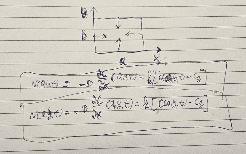

I have a discussion with a colleague of mine.
We have a thin cuboid sample whose two dimensions are similar to each other and are both much bigger than the sample thickness. I'm doing an experiment in which the diffusion of some species is induced and its diffusion profile is measured in one of the sample directions. Diffusion profile is fitted to the solutions of the diffusion equation (Fick's 2nd law) to obtain material properties.
Since the two dimensions of the sample are similar and I'm only measuring the diffusion profile in one of these two directions, is it meaningful to fit this profile to the one-dimensional diffusion equation solution? If you ask me, the answer is no. My colleague claims this can be done.
The problem is that the diffusion rate (molar flux) is similar in both dimensions (directions) and therefore concentration time change at any point is affected by the fluxes in both directions. Hence, we must measure the concentration profile over the sample surface and fit it to the two-dimensional solution.
Who do you think is right here? Can diffusion be modelled as one-dimensional?

What you have described is a 2D diffusion problem. Concentration will be a function of 2 coordinates. If the outer boundary were circular concentration could be described by a single radial coordinate, and the problem would be 1D.
Yes, that's what I think also. However, diffusion profile is measured along one of the coordinates. Therefore, one of the coordinates is kept constant and diffusion is effectively modelled as 1D although 2D solution must be used. What confuses me a bit here is that the value of constant coordinate (let's say ##y##) will depend on the choice of the origin of the coordinate system and that seems to affect the concentration calculated from the model (and it shouldn't matter where we put the origin).
For example, if the sample has a surface of 5x4 (mm) and diffusion profile is measured along the y-coordinate 1mm from the the top than y-coordinate can be 1mm or 3mm depending on what sample edge we place the coordinate system origin. It would seem that plugging different y-coordinate values in the same solution of the diffusion equation would give a different result.

I'm not sure I understand this. The problem is I can't find the analytical solution for the 2D diffusion for my initial and boundary conditions.
Also, I realized I made a mistake earlier in boundary conditions. Here, I'll outline all initial and boundary conditions.
Initial condition is the same everywhere on the plane, some value of concentration: $$c(x,y,0) = c_0$$ Physically, this would be a background concentration of the tracer inside the sample.
Boundary conditions:
In the middle of the plane, ##(x = \frac {a}{2},y = \frac {a}{2})##, concentration remains constant through the whole process. It's time independent and equal to the background tracer concentration. In another words, diffusion fronts from the opposite sample faces don't overlap. $$ u(\frac {a}{2},\frac {b}{2},t) = c_0 $$
On the plane boundaries, Dirichlet boundary conditions are imposed. Concentration isn't defined directly on the plane boundary, but the mole flux of the diffusing component: $$ N(0,y,t) = -D\nabla c(0,y,t) = k[c(0,y,t) - c_g] $$ and $$ N(x,0,t) = -D\nabla c(x,0,t) = k[c(x,0,t) - c_g] $$
Essentially, it's assumed that the mole flux on the boundary is directly proportional to the concentration difference between the component on the boundary and outside of it, ##c_g##. Physically, this can be understood as the component existing in the gas phase with concentration ##c_g##and entering a solid plane via some physicochemical process. Concentration, ##c_g## can also be defined as the equilibrium concentration on the plane when concentration gradient ceases at all points of the sample, ##t \rightarrow \infty##.

This makes no sense to me. Please provide a sketch (diagram) in the x-y plane. Also, it makes no sense to say that somewhere within the body, the concentration is constant, since, at long times, the concentration must approach ##c_g# everywhere within the domain.
Well, I think it means that the diffusion front doesn't reach the centre of the sample during the time frame of the process. Concentration gradient at that point remains zero inside the concerned time frame. If the time is long enough, diffusion front will reach the sample centre and concentration at that point will start to change. It could easily be I'm looking at this incorrectly.
Maybe as soon as non-stationary diffusion starts, mole flux is non-zero at every point in the sample.

You have mass flowing into the plane but not out. So the latter interpretation is correct, and the concentration at these boundaries will change until they too ultimately reach ##c_g##.

The sketch is provided.
There is a flux across all 4 sides. Mole flux is in the opposite direction across the mutually parallel sides. It's something to include in the boundary conditions.
Hmm, it seems I've got some things to think about. In this problem, as it can be seen on the image provided, component diffuses through all 4 faces of the plane. I thought that concentration change in the sample centre can't change before the component coming from the plane edge arrives at that point. As component (oxide ion in my case) diffuses with finite velocity, it takes time for it to reach the centre. In another words, how can concentration change in the centre before any molar flux is present there? If there is no molar flux, how can its divergence be non-zero value?
Dario56 said:
The sketch is provided. View attachment 339991
It's true that only normal component contributes to molar flow across the boundary. The problem I had is that ## k(c - c_g) ## expression silently assumes normal component of the mole flux while that isn't explicitly written in the sources I've read. I thought molar flux in general is defined on the boundary.
No. ##k(c-c_g)## is the molar flux away from the boundary in the direction normal to the boundary. Neither flux vector nor magnitude of the flux vector is continuous at the boundary between the two media. Only normal flux components in the media on the two sides of the boundary are continuous.
