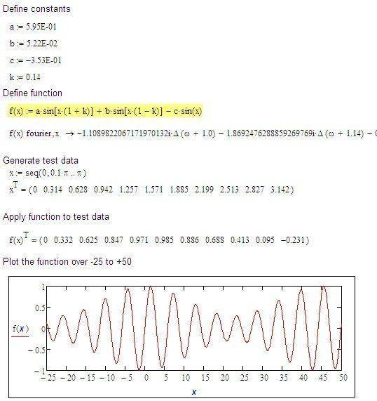

I may not have understood the problem, though. It seem as though any of the mathematical applications should handle giving you values as it looks as though you have, implicitly, a straightforward function of x. For example, implementing it in Mathcad gives the following ...

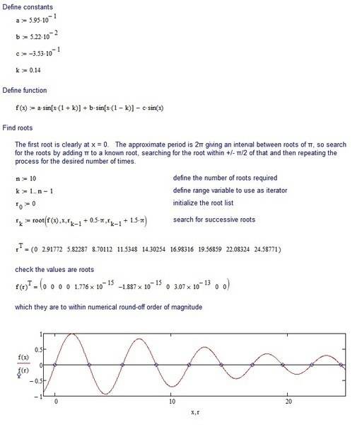

Silly me ... didn't read the question properly. A Mathcad solution validating the Mathematica one:
Thank you for your answers.
I was too much trying to find a solution that I didn't plot the curve.
I will try to take all the roots and implement them in my next equation.
