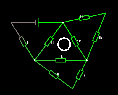

If I have the circuit below, and the white circle is Infinite Coil with current of I=xt, Counterclockwise, with a radius a. from Faraday's law we know that will be Electromotive force .
2. Homework Equations
what the EMF in needed to stop the current at the middle R ?
(the question ask what the x is needed but that easy if I know the EMF )
I tried to create more battery but where I can connect her? there is different if it will be at the middle wire or another wire .

for I can understand where I put the EMF I founded, if the coil was at the left circuit? the EMC need to be V if I want no current at middle?
and if I have a circuit like I made (new image) . I can know where to put the DC for replace the coil?

snir said:
Thanks
Yes to the first question.
And for the second i think the original problem is intended for the student to learn about faraday law, flux, induction etc. But no to go further to complicated configurations. I mean in more complicated circuits you would need to analize the electric field in every point.
I general when the problem involves field theory one has to forget about circuit models and analize the problem using maxwell equations in space for that more information is needed like charge density. Charge distribution over space. And how the conductor or diferent materias of the circuit are distributed in space.
and if I have a circuit like I made (new image) . I can know where to put the DC for replace the coil?[/QUOTE]
Besides what I posted before I see your second circuit is interesting. I would think of it like being two loops with triangular shape one inside the other and the emf induced would be like adding a dc source to every branch of the circuit. Then maybe could be analized using kirchhoff law. (still as i posted before would be something aproximated)
