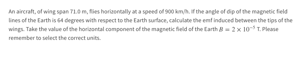

Calculate EMF induced on tips of an aircraft wing

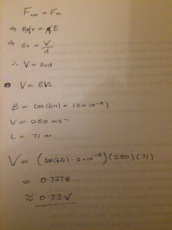

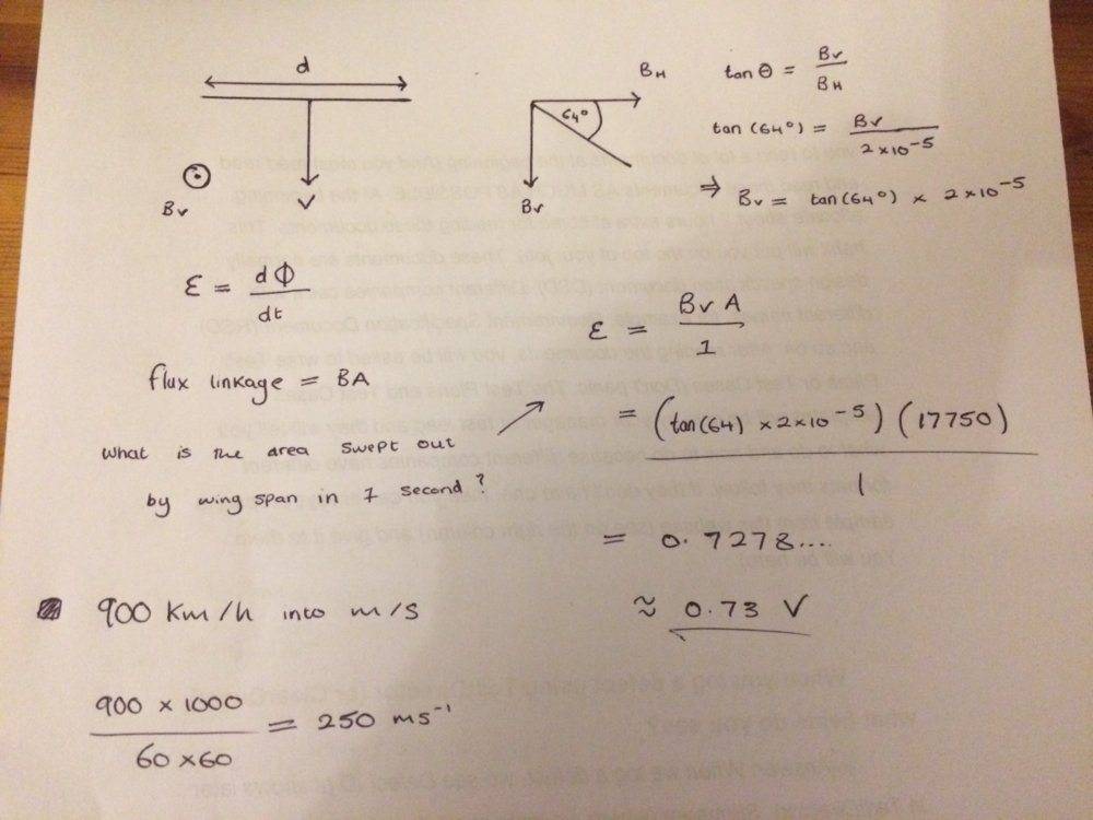

I have a simple sketch of the diagram, and I know I must use the vertical component of the magnetic field of the Earth when doing this problem
I got an induced emf of 0.73 volts but I do not know if I correctly substituted the right values into faraday's law equation?
Any help will be really appreciated! Thanks
I agree with the answer you gave, though I think you're supposed to treat the wingspan as a conducting rod. Like @berkeman mentioned, there isn't a rate of change of flux linked in the actual wing, only the flux linked in an imaginary loop like below:
We then have ##\varepsilon = B_{v}lv## where the three terms are mutually orthogonal.

The Lorentz Force will exert forces on the electrons in the wing material, so maybe there is a way to calculate the voltage generated that way. The force due to qv X B will be balanced by qE, so there will be an electric field pointing along the wing. That will generate a small voltage, but I don't think you can use dΦ/dt to do the calculation, since Φ is not changing.

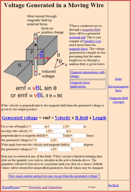

Do you get that same answer when you use the Hyperphysics calculator that I linked?
Yes :)

I second that. In general it is dangerous to apply maxwell' s equations (which is what Farady's law is based on) to moving media.
The correct way is to use the Blv law which is what @berkeman stated.
