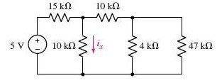

What is ix (in μA)? Given all R and V.
V=IR
I reduced the circuit into just one Req = 20.778 kohms and find the current through the reduced circuit to be 240.6375 uA (5V/20778 ohms). Since current flowing in series is the same, Ix through the 10 kohms is also 240.6375 uA.
Would anyone please tell me where I am doing wrong here?
Many thanks in advance!
The element carrying Ix has a path in parallel to it: the current through the 15k resistor is shared between two parallel paths.
What did your circuit look like just before you collapsed it all into one resistance? :smile:

what u r finding is the total current. the current however splits into 3 branches at the junctions. i wouldn't recommend this problem until u have covered kirchhoffs law

It was 15 kohms + the reduced resistance (including 10, 10, 4, and 47 kohms resistors). Do you mean that the current I found has to be divided between the 10 and the rest of the reduced resistors (10, 4, 47)?

I did. I just need to practice more. So I thru 15 = I thru 10 + I thru combined (10, 4, 47)?
Yes.

I got I = 139.0438 μA.
Looks right.
