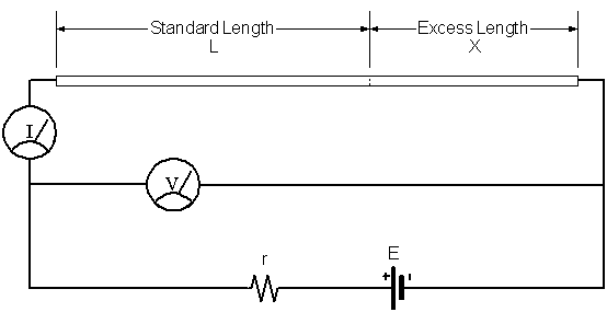

OK, just to clarify, I will re-discuss the concept of my experiment.
In an Extended Experimental Investigation (EEI), I am investigating the effects that wires of various resistivity have on current density. Four different wires were used in four different trials, iron, tinned copper, constantan and nichrome, with the current and voltage drop in the circuit recorded for each. I attempted to retain the same length of wire for each separate trial, but the DC power pack I used for it would overload under lower wire lengths, so for each wire I used the maximum amount of length possible to prevent this. As such, a variable I want to control, wire length, had been manipulated.
As I am comparing resistivity against current density, wire length and thickness must be kept constant. To achieve this, I have attempted to normalise the resistance figures I calculated from (R=V/I) for a wire length of 10m and thickness of 1mm, leaving only resistivity as an manipulated variable. However, this new normalised resistance will have affected the values of V and I (in R(normalised) =V/I) and these new values are unknown.
Is there anyway to determine the normalised current from the normalised resistance, as more then two variables are unknown for this normalised Ohm's Law equation?
Suppose that you have some desired standard length L for the wire, and you've used a longer piece with excess length X. The total length of the wire is then L + X.
If you assume that the wire is uniform in cross section and material then L and X together will have some resistance R = k(L + X) for a linear resistivity constant k. Individually the sections of wire have resistances kL and kX.
Now, with voltage V applied across the full length of the wire the two resistances kL and kX will form a voltage divider. The voltage across the Standard Length will be given by:
[tex]V_L = V \, \frac{L}{L + X}[/tex]
Since the L and X are in series the current is the same through each. So the resistance of the Standard Length of wire will be VL/I.
Does this diagram correspond to your setup?
Circuit schematic of a slide-wire setup: a horizontal wire spanning Standard Length L and Excess Length X, with an ammeter I and voltmeter V connected across it, in series with resistor r and battery E.
  • Circuit schematic of a wire with a Standard Length L and Excess Length X marked above it, with an ammeter I and voltmeter V, a resistor r and a battery E in series below.

OK - now I get you: you seem to be using the word "normalize" in a way I'm not used to.
Lets see if I have understood you ...
Your data consists of:
wire, length, diameter, voltage, current
wire type and diameter is read off the label while the rest are measured directly.
You need to know what the current would have been if the voltage was the same amount for each over a 10m length of the same wire. Is this correct?
You cannot do this without assuming a relationship between the current density and the resistivity. Your experiment is, as you suspected, broken.
You could have improved your original design by adding a voltage divider with a rheostat - you'd use the rheostat to set the voltage that was dropped across the test-load while a small known load stops the PSU overloading.
But one thing puzzles me - how were you expecting to measure the resistivity of the wires without assuming a relationship between resistivity and current-density?

gneill's digaram is pretty much correct, except there is no resistor ('r' in the diagram). Are you suggesting that to find normalised voltage I can use the equation you stated, and then substitute that into I(normalised) = V(normalised)/R(normalised) to identify I(normalised)?

Note, if you "normalize" to 1m, the normalized voltage will be the electric field. You would then "normalize" your current by dividing it by the cross-sectional area of the test-wire... which would be the same as the current density.
There does not seem to be any point, in the context of your experiment, of normalizing to 10m by Gniell's suggestion because it's basically what I just outlined. (Remember, the current through all sections of the wire is the same?)

Resistor 'r' is meant to indicate that the circuit wiring itself will have some resistance. It won't play a significant role in your lab if the voltmeter is connected directly to, or at least very close to, the test-wire.
The current in a series circuit is everywhere the same. So your In will be the the same as your measured current. What is different is that the voltage across the standard length segment of wire isn't the end-to-end voltage that you actually measured, but a fraction of it as given by the formula. Note that this voltage is then a derived value, not a measured one; Its validity for your purposes depends upon making reasonable assumptions and arguments about Ohm's law, uniformity of the wire, symmetry, Kirchhoff's laws, etc.
You can always derive values from the measured data as part of your analysis provided that you can justify them. This may involve a short discussion and derivation in the Theory section of your lab write up.
