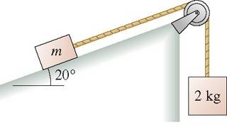

It's the same diag. but the blocks are A and B and the angle is 30°
Theta=30°
Block A=15kg
Block B=12kg
assume the rope is massless
us=.25=coefficient of static friction
What is T?
My Attempt at a solution
I made FBD for both block A and B
For A sum the forces
Fx=t1-m1gsin30°-f=ma
fy=N1-m1gcos30°=0
Block B
F=m2g-T2=m2a
So I'm looking for the Tension in the rope. Is it just 1 rope or 2 ropes? I really don't know what to do now. Do I find t2 before i find t1? Do I find the acceleration before I find the Tension?
Thank you!

from the diagram, it's one continuous rope, so (if the pulley is smooth) the tension is the same all the way along, and you can just call it T :wink:
fy=N1-m1gcos30°=0
Block B
F=m2g-T2=m2a
fine so far :smile:
now write f in terms of N, and you'll have two equations with two unknowns (a and T) …
eliminate one and find the other :smile:

yes, f = .25 n1 is the extra equation :smile:
(except, I've just noticed, that's the coefficient of static friction, so it only applies if a = 0 … perhaps he means dynamic friction?)
(and yes n1 is one of your unknowns, but you can get it from your n1 - m1gcos30° = 0 :wink:)

you had T - m1gsin30° - 31.825 = m1a
and m2g - T = m2a
to find T, you need to eliminate a, so multiply the first equation by m2 and the second equation by m1, and then subtract

yes, that's the right method, but in A you've missed out the m1gsin30° :smile:
(alternatively, if you only want T and not a, then you could eliminate a instead of T :wink:)
