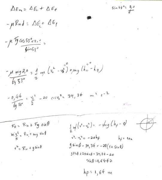

I've done this:
JoanF said:
I've done this:
Is it correct??
JoanF said:
Is it correct??
Unfortunately, I'm finding your work a little difficult to follow. My answer differs from yours, so one of us is making an error.
What I did:
Found the total energy of the mass when let go from A.
Found the new total energy of the mass when let go from B.
Found the condition for losing contact with the surface.
Combined the last two to solve for the height at which the mass leaves the surface.
If you summarize the results you get for each of those steps, perhaps I can see where we differ.
using g=10, I got: h=1,64 m
using g=9,8, I got: h=1,4456 m
I've done just like you
OK, my answer agrees with your second result.
If you were to solve the problem symbolically, only plugging in numbers at the last step to get a numerical answer, you'd see that the answer does not depend on g or m. (They cancel out.) Whenever possible, that's the best way to go, since it reduces the chance for arithmetic error.
