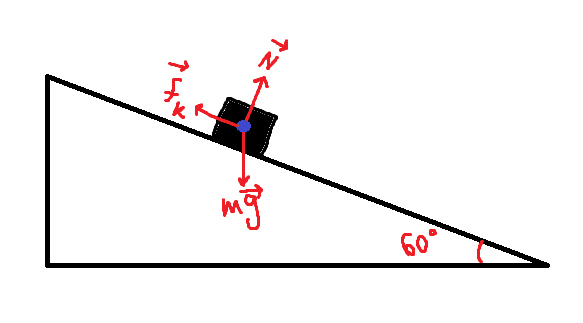

Body starts to slide down the 60degree incline plane and after 20 meters reaches speed of 4 m/s. What is the coefficient of friction?
acceleration due to gravity under angle ->Fg=mgsin60, Normal force -> Fn=mgcos60, Ffriction = mi(coefficient of friction)*Fn
So basically I need to find the coefficient of friction given the listed information.
What bothers me is that I am getting two different accelerations for two different approaches. When I calculate acceleration using Fg=mgsin60 I do it this way: Fg=mgsin60 -> ma=mgsin60 ->a=gsin60 -> a=8.66. But when I use formula ##v^2=2as## I get a=0.4.
After I got a using Fg=mgsin60 I use Ftr=Fn*mi -> ma=mgcos60*mi -> ##\frac{a}{gcos60}=mi## -> mi(fr coef)= 1.73. Which makes no sense, since body is moving and coef of friction can't be greater or equal to 1 if body is moving.
And using a I got from ##v^2=2as## -> ##\frac{a}{gcos60}=mi## -> mi= 0.08 and that makes sense, BUT the solution in the textbook is 1.65, so I am really confused. I suppose it's mistake in textbook, but why am I getting two different soltions for a?
So yeah, if you could please explain I would be very grateful,
thank you.
That assumes no friction. Try including the frictional force in the equation.

You want to find coefficient of friction. But you have forgotten the firiction force in your answer!
Try to add a X-Y coordinate system and find component of each force in ##x## and ##y## direction. Then apply ##\vec F_{net}=m\vec a## ! You should know that the mentioned vector equation equivalent to three component equations! So you can find equations you have mentioned in post #1 without forgetting the firiction force.
@MatinSAR, @haruspex. I got it, thank you.
@kuruman, I had no idea that mi can be >=1, there was a question in the textbook if mi can be >= 1 and the answer at the end was that it can not. I never checked that, just accepted it as a fact, but after checking I realized that it obviously can be, thank you for telling me.
