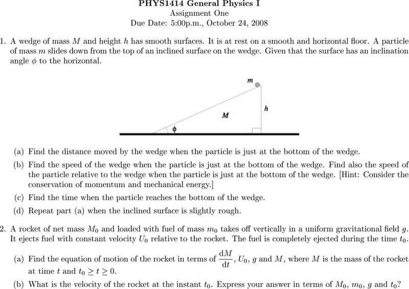

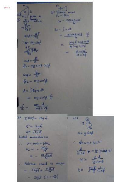

It seems I should do part c before part a because part a requires the time.
And for part d, the distance that wedge moves is less than before, it is correct?

kuruman said:
Check your answer to part (a). It is not dimensionally correct and should depend on the sliding mass too, not just the mass of the wedge. Hint: How far does the CM of the wedge plus particle system travel when the particle reaches bottom?

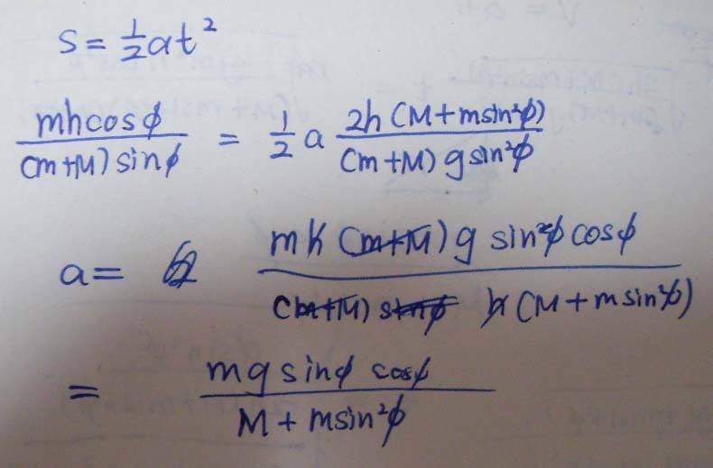

The center of mass doesn't move, and I obtain the answer
mhcot(phi)/(m+M)
But now I am not understand what is the acceleration.
It seems the only acceleration of the wedge is caused by the particle.
So my method to obtain acceleration should be correct.
But why the acceleration I obtain is not the true acceleration?

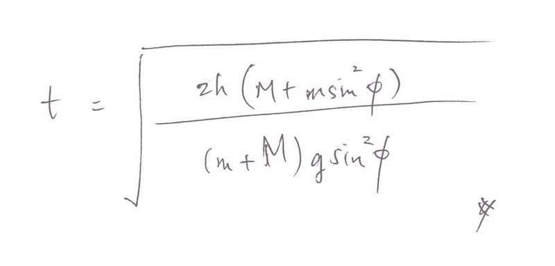

Sorry, I forget to upload new photos.
My tutor gives me the answer of the and I try to use this answer to find acceleration.
But the result doesn't match my work.
So the 'true' acceleration I said refers to the acceleration obtain via answer.
So my question is
Why my work is wrong?

To find where you went wrong, we need to backtrack and answer the questions in the order that the problem asks them.
You have correctly found the answer to part (a)
[itex]x=\frac{mhcos\phi}{(m+M)sin\phi}[/itex]
What is you answer to part (b), the speed of the wedge when the particle reaches bottom and how did you get it? You need the speed to find the time.

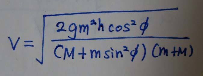

By using K.E.=P.E. and conservation of p I obtain this. (The steps are too long and I am sure it is correct because I have the ans.)
So what's wrong with my work?

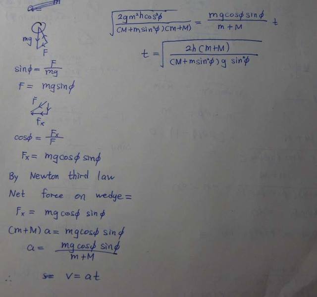

My new attempt to obtain the time.
Can you tell me why the acceleration is wrong?
It's a bit hard to follow what you are doing. What does F = mg sinΦ signify? And Fx = mg sinΦ cosΦ? Is that supposed to be the x-component of the normal force? (It's not.)
The only force the mass and wedge exert on each other is the normal force. But note that since the wedge accelerates, you'll have to solve for that normal force.
You are trying to get the acceleration from a free body diagram. You should in principle get it that way if you draw separate FBDs for the wedge and particle and not assume that they have the same acceleration. Your equation (M+m)a = mg cosφ sinφ assumes that. An easier way to find the time (and that is why the questions are sequenced that way) is to use
[itex]\Delta x=\frac{1}{2}(v-v_0)t[/itex] because you already know the displacement and final velocity from parts (a) and (b).
Also, I don't seem to get the factor (M+m) in the denominator under the radical for the speed expression. I just get M. Are you sure it is in the answer that you have?
My tutor send me a full solution.
Maybe you can take a look.
kuruman said:
Yes, of course. I forgot the relative velocity.:blushing:
Although you have given me a method which can avoid the value of acceleration.
I still want to know how to obtain the correct acceleration from FBD.

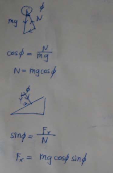

It's a bit hard to follow what you are doing. What does F = mg sinΦ signify? And Is that supposed to be the x-component of the normal force? (It's not.)
I can also obtain Fx = mg sinΦ cosΦ from the normal force
The normal force is not mg cosΦ. That would be true if the wedge were fixed, but not true if it is allowed to accelerate.
I will elaborate on what Doc Al suggested. The normal force is no longer mgcosφ when the wedge accelerates. It is mgcosφ when the wedge is at rest with respect to the Earth, i.e. in the limit when the wedge's mass goes to infinity. As I said, you need to draw two separate free body diagrams, with the two masses having different accelerations, and then find what the normal force ought to be in order to be consistent with these accelerations.

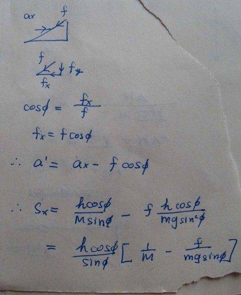

Now I am wondering how to do the final part, part d.
The answer said the since it is interal force, it won't affect the result.
But I don't understand why.
Do not try to solve this one by solving for the accelerations first. Friction consumes energy, its slows down the motions and increases the time for the particle to reach the bottom of the slope. But the CM of the whole system does not accelerate, as no external force acts in the horizontal direction.
You found the answer to part (a) by conserving momentum in the horizontal direction and saying that the CM does not move. Does the CM move when you turn friction on? If so, what is the net horizontal force that causes it to move?
