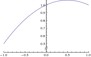

See the graph of [itex]\ \displaystyle kt^2-kt+1\,,\[/itex] with k = -1/4, restricted to -1 ≤ t ≤ 1 .
Because the domain of this function is restricted to [-1, 1], the function's range does not include any negative values.
from WolframAlpha
Added in Edit:
Of course, the graph of [itex]\ \displaystyle k\cos^2(x)-k\cos(x)+1\,,\[/itex] looks nothing like the above graph, but both graphs have the same range for k = -1/4 .
