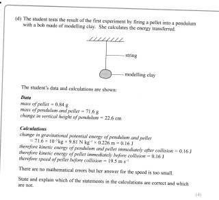

Mg deltha H
1/2mv^2
p=mv
I believe statement to do with the Gravitational energy is correct, considering the equation I listed. I would have to agree with statement 2 since gpe=keHere is what I am thinking, I disagree with the Ke = the same as before collision.
my reason is 1/2mv^2= 0.16j ----- v= sqrt (0.32/71.6ex-3) now if this is correct we can work out the momentum
which i have down as 1.5 x10^-1 using, momentum is conserved we can work out velocity of the pellet which turns out to be 180m/s (I think this could be wrong)
But could I just say that, the collision was inelastic, hence kinetic energy is not conserved, therefore working out velocity from Momentum would be better since momentum is conserved.

Good answer.

I was being quite serious :smile:. You correctly identified the flaw in the student's reasoning, and that the correct way is to use conservation of momentum.

but doesn't 180m/s seem to big of a value for the velocity.
No, it looks right to me. Remember that the pellet is only 1/90 of the mass of the ball.
