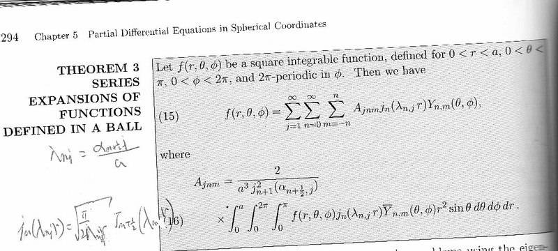

\frac{\partial{u}}{\partial{t}}=\frac{\partial^2{u}}{\partial{r}^2}+ \frac {2}{r} \frac {\partial{u}}{\partial{r}}+\frac{1}{r^2}\left[\frac{\partial^2{u}}{\partial{\theta^2}}+\cot\theta \frac{\partial{u}}{\partial {\theta}} +\csc\theta\frac{\partial^2{u}}{\partial{\phi}^2}\right]+q(r,\theta,t)
Where 0<r<a,\;0<\theta<\pi,\;0<\phi<2\pi,\;t>0
with Boundary condition u(a,\theta,\phi,t)=0 and initial condition u(r,\theta,\phi,0)=f(r,\theta,\phi).
I understand how to get to
u(r,\theta,\phi,t)=\sum_{j=1}^{\infty}\sum_{n=0}^{\infty}\sum_{m=-n}^{n} B_{jnm}j_{n}(\lambda_{n,j}r)Y_{n,m}(\theta, \phi)e^{-\lambda^2_{n,j} t}
What I don't understand is the next step, the book assume
g(r,\theta,\phi)=\sum_{j=1}^{\infty}\sum_{n=0}^{\infty}\sum_{m=-n}^{n} g_{jnm}j_{n}(\lambda_{n,j}r)Y_{n,m}(\theta, \phi)e^{-\lambda^2_{n,j} t}
Where g_{jnm} is another constant.
How do you justify to assume g(r,\theta,\phi)?

I think you said the same thing as the book said. Actually the book say the same thing:165887[/ATTACH]"]
But I just don't know how to justify this.
Also, what is a Square Integrable function?
Thanks

So what is the significance of f(r,\theta,\phi) being a square integrable function that gives (15) in the book? The book does not explain anything how to get (15).
First, what does complete mean? In 1D a set of functions \{\phi_n(x)\} is complete if, for a square integrable function f we can find coefficients \{a_n(x)\}such that
<br /> \lim_{N\rightarrow \infty} \int \left( f(x) - \sum_{n=1}^{N} a_n \phi_n(x) \right)^2 \, dx = 0.<br />
In other words, it means you can approximate the function as well as you want in the mean-squared sense. In 3D it is essentially the same. It is well known that the problem you are working with has complete eigenfunctions. Proving completeness is really the job of a true mathematician - I certainly cannot do it for you!
Jason
So I just have to take it at face value. It kind of make sense as they are all in the same form. Maybe that's the reason the book gave the theorem 3 as show without going into it at all.

In some sense yes. However, if your operator is self adjoint, then we know from linear algebra that for finite dimensions you have a complete set of orthogonal eigenvectors (spectral theorem). In the infinite dimensional case like you have with PDEs I don't think it is necessarily true, but it is typical for engineers to assume completeness for self adjoint operators (like the Laplacian) and move on.
I do know that variational approaches can be used to prove completeness, and probably other methods as well. Years ago I attempted to learn how to prove this just for fun, but gave up. Either I wasn't willing to work hard enough, or didn't have a strong enough analysis background, or wasn't looking at the right resources (or all of the above).
