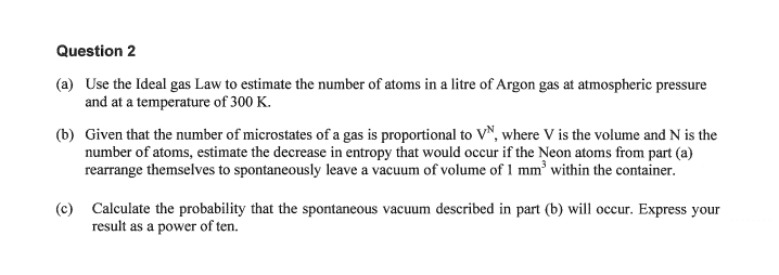

PV=NkbT
Change in entropy = Boltzmann Constant x In(Macrostate)
for part A, I knew that PV=NKbT
giving that pressure is 101300Pa volume is 1*10^-3 m^3, Kb is 1.38*10^-23 and T=300K
I find N to be 2.446*10^22 atoms
the problem I have is with part B
the question states that microstate is proportion to V^N where N is the number of atom I found in part A, and V is the volume which is 1*10-9 m^3. Thus V^N is a very small number which is pretty much zero. Change in entropy = Boltzmann Constant x In(Macrostate), since Macrostate is zero, there is an error in this calculation. Since In(0) is undefined. What am I suppose to do in this question??
I forgot to attach the question, here it is
Hi Junkwisch!
Always in physics things are only big or small relative to other things. The numerical value of [itex]V^N[/itex] depends entirely on what units you're using.
Perhaps you can simplify [itex]\ln\left(V^N\right)[/itex] without making an approximation? :smile:
You should check that you have the correct relationship here. How can the left side of the equation be a change when there's no corresponding change present on the righthand side of the equation? Also, what is "Macrostate" supposed to represent?
