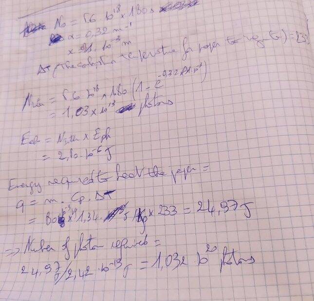

meher4real
65
Determine the heat delivered to the interaction space in three minutes, if the amount of 5.6.10^18 photons per 1 s hits the area of 1 cm2 and the absorption coefficient for a given wavelength is 0.32.
E=hc/wavelength
N(interaction)=N0(1-e^-µx) and E(ab)= N(interaction) x µ(ab) x E
Hi Guys !
Previous question was to determine the energy of photon with wavelength = 820nm
I found that E = 2.42x10^-19 J = 1.51 ev using the equation E=hc/wavelength
- I tried to solve the above problem with various equations but all failed.
The closest equation i tried is N(interaction)=N0(1-e^-µx) and E(ab)= N(interaction) x µ(ab) x E
Please i want to know if I'm on the right equation to solve the problem ?!
Although μ in the context you present is called the absorption coefficient, it doesn't look like you want to go there because no distance x is given through which photons move. Also, the number 0.32 has no units. I suspect it is an absorption efficiency, i.e. 32 % of the incident photons are absorbed and converted into heat.

kuruman said:
Perhaps the answer to the second part is intended to be a mathematical expression in the form $$N= N_0\left (1-e^{-\mu~x}\right)$$where ##N## is the number of photons absorbed to a depth ##x## from the surface. You have a length of 1 mm in part 3 so you can calculate the number of photons absorbed. The question remains whether 0.32 is in m-1, cm-1 or mm-1. Perhaps you can do a web search and find out what's reasonable and what isn't. While you're at it, look up the combustion temperature for paper. You will need it for part 3.
That's exactly why i asked for help here, bacause I've tried using that equation but the result is to big
I took 0.32 m^-1 as absorption coeff, 0.1x10^3 m as length, 5.6x10^18 x 180s as N0
i get from that 1.01x10^21 ?
Then I'm thinking on this equation to determine the E(absorption) = N(interactions) x µ x E(photon) ?
Any thoughts ?

I Think that 3.23x10^17 eV is the transmitted energy.
How did you calculate that number? Show me the equation and the numbers you put in it.
where 0.32 m^-1 as absorption coeff, 0.1x10^-3 m as length (paper 0.1 mm thick), 5.6x10^18 x 180s as N0
Correction : I found 1.03x10^13 ev

kuruman said:
Is that what you want? How are you going to use the transmitted energy to find if there is enough energy to set the piece of paper on fire ?
The only think I'm sure about at this point that i have to use (cp = 1.34 kJ.kg-1.K-1)) and weight on my next equation.
But don't know how because I'm thinking about : E(absorption) = N(interactions) x µ x E(photon)
The question in part 3 is:
Is the supplied heat enough to ignite a sheet of classic office paper 0.1 mm thick and with a (specific surface area) weight of 80 g.m-2? (cp = 1.34 kJ.kg-1.K-1))?
What strategy is needed to answer this question? By this I mean what do you need to know? Is calculating the absorbed energy sufficient? If not, what else do you need to know or look up or calculate? Hint: Not all things that absorb energy ignite. Why not?

By the way, is N found is the absorption energy ? is it the right result for part 2 ?
N is the number of absorbed photons. How would you find the absorbed energy if you know the number of absorbed photons and the energy of one photon?
