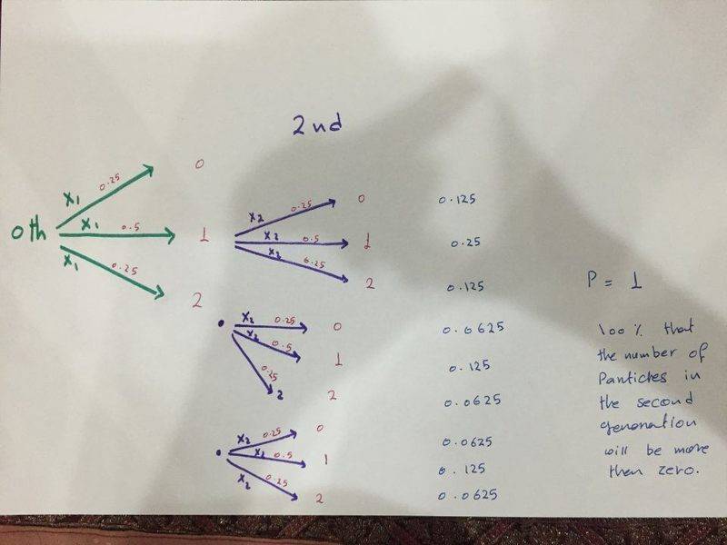

https://fly.cloud.photobox.com/2984919587ea968d6b9e99fdd1b96c87d958717a3c978173f83c89a622c049a69cc2da81.jpg
is this correct ?
I think I should not calculate the zero particle ,, right ?

That's a good approach. Remember that if 2 particles are created in the first generation, then both of these will decay independently in the second generation. So, you need a bit more work on the case where ##x1 = 2##

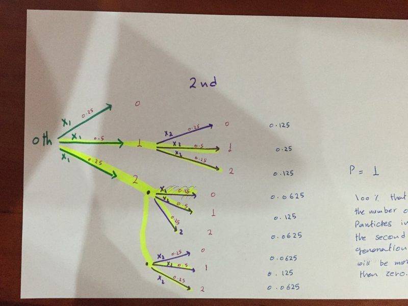

how about this ?
and for part b :
P= 25%

I'm not sure how you get ##P(x2 > 0) = 1##
There are three ways you can end up with 0 particles:
##x1 = 0##
##x1 = 1## and ##x2 = 0##
##x1 = 2## and ##x2 = 0## (for both particles)
For part b, how do you get 25%?

well, the problem ask for the probability of getting number of particles in the second generation more than zero ... not equal to zero right ?
so I sum up all the probabilities of getting 1 particle and 2 particles in second generation .. I will highlight the path in the attached photo
I get P=1 when I sum all the probabilities even with getting zero particles .. but now if I remove them I get P=0.75
##P(x1 = 0)## = 0.25
Hence ##P(x2 = 0) > 0.25##
You must have made a mistake adding up.
