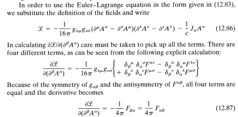

I disagree, if you have a look at Jackson's Classical Electrodynamics book (can download at https://physicsdir.wordpress.com/2018/11/02/classical-electrodynamics-solution/)
In section 12.8 he clearly uses that property to find the laws of motion. It is cut short but i have derived the entire process and i got the same result.. the laws of motion for the proca lagrangian i presented in my summary are def the correct ones since lecturers also approved.. but please, explain what's wrong with the indices? To elaborate, i used the identity $$\frac {\partial(\partial^\mu A^\nu)}{\partial(\partial^\beta A^\alpha)}=\delta^\alpha_\mu \delta^\nu_\beta$$(which by the way i found from another forum in this site, and has helped another student with a similar purpose)
this is what has been working for me through the project
I don't know which edition you have, but the one I have there no such equation in section 12.8.
In any case, it is wrong at least with my understanding of the notation (and I'm not aware of any other notation that would make this correct, but if it is in Jackson...)
In any case, I don't care if it is in Jackon, or in the Bible. Compute the case ##\mu=\beta=1##, ##\nu=\alpha=0## as I did and tell if this equation holds...

I have attached the note from Jackson's book where it gives the technique for the notations i used.. I'm confused to why this doesn't work. Do you have a source where i can study those kronecker delta identities better maybe? I've been trying to google them but can't find any and it would help a lot
Seem perfectly fine, can you send a picture of where it says this:
Because this seems incompatible with what you just send

I'm a little bit confused, does Jackson use the property ##\frac {\partial(\partial^\mu A^\nu)}{\partial(\partial^\beta A^\alpha)}=\delta^\alpha_\mu \delta^\nu_\beta##? If it does, can you please send a picture of that part?
If it does not use that property, where do you get that property from? I'm telling you that property is wrong as far as my understanding goes. You have shown me a picture of Jackson's book where that property is not used and indeed everything seems fine. You have also linked a post where this property is never used and also, everything looks fine.
I have also shown you that this formula is clearly wrong unless you use very strange and weird conventions (and I'm not sure if such conventions even exist).
So please, can you prove this formula? Do you know of any textbook that uses such a formula? (and proves it, of course)

Jackson totally skipped the steps between to show them unfortunately. And if the formula in the post is correct but I'm still getting it wrong then I'm seriously lost as to how i got the same answer lol.
But by computing the guesses i made i understand why they're wrong since kronecker delta cannot have indices that are different in order to be equal to 1 and not 0. So is the answer $$\frac {\partial(\partial^\mu A^\nu)}{\partial(\partial^\beta A^\alpha)}=\delta^\beta_\mu \delta^\nu_\alpha$$??
