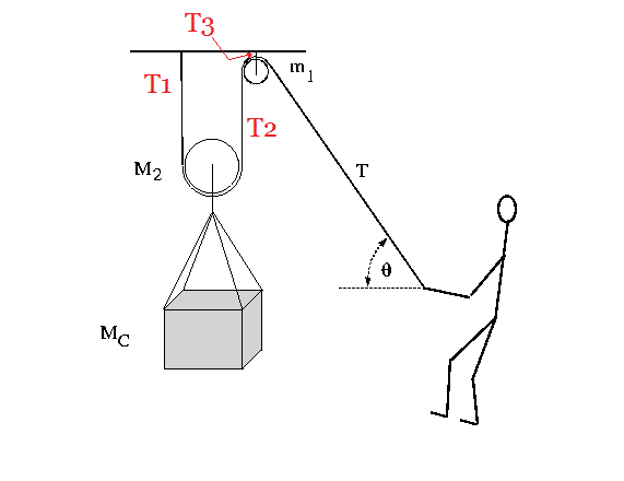

A crate is pulled up using frictionless pulleys in the manner shown in the figure. The angle is 45 degrees. The masses are, for the small pulley, m1=3.5 kg, for the traveling pulley, M2=6.5 kg, and for the crate, MC=44.2 kg. What is the minimum tension with which the operator must pull on the cable (assume the cable is of negligible mass) in order to slowly raise the crate.
(See the attached picture below)
First of all note that in the diagram attached, the BLACK parts are the original question, and the RED parts are things I added to help in solving it.
1) I know that T3 has to support at least m1. How would I figure out how much of M2 and MC it supports?
2) Does the Y component of T (ie. Tsin45) equal T2 in the diagram?
3) Since the problem says "slowly raise", does this mean that net force in the Y-direction is zero?
Well I drew FBDs at m1, and M2 and ended up with these statements:
At m1:
T3 + Tsin45 - T2 - m1g = 0
At M2:
T1 + T2 - M2g - MCg = 0
But seeings there's only 2 equations and 4 unknowns it seems unsolvable.
There must be SOME relationship between T, T1, T2, and T3 that I'm not seeing.
Thanks in advance,
Mike

In this situation, since all the tensions are from the same string, T1=T2=T3=T
Its the same string without any node. any pull on the other side will affect the whole string right?
Ok that seems like it makes sense...one more question though.. how would the pulley with mass = m1 affect the system? Since it's attached to the ceiling wouldn't it's weight be canceled out by T3?
m1 won't take any account unless it has friction.
Alright thanks, I'll try to solve this again now. I appreciate your help
I got an answer of T = 351.7N but unfortunately that's not right.I came up with the statement:
T1 + T2 - M2 - MC = 0
Where T1 and T2 = Tsin45
So:
2Tsin45 = 497.367N
and T = 351.7N

The only thing I can figure is that the tension on the left side of the larger pulley is different than the tension on the right side of that pulley

248.7N was the correct answer...so thanks!
I guess no matter what the angle T is at it will always be equal to the tension on the other side of the pulley
