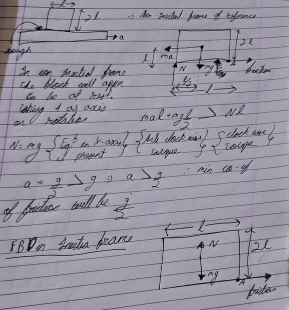

A rectangular plate is placed on a rough plank. Dimensions of the plank is as shown in the figure. Find:-
minimum acceleration with which the plank should be moved so that the rectangular plate topples (conside the friction is sufficient so the plate does not side).
Torque = r×F , friction = u.N , F= ma
So i solved this question through non inertial frame but how do i solve this through inertial frame , when i used to solve only translation question when i observed through non inertial frame the main difference was in inertial frame Fnet = 0 and in non inertial frame Fnet -ma =0 (ma being pseudo force ). But now the absecnce of ma (psuedo force ) in FBD leads to improper calculation of torque. How do i solve this through inertial frame . My workings in non interial frame and FBD for inertial frame are given in the picture attachment

When you solve the problem as you did, you are not using Newtons Laws in a non-inertial frame. We are applying a fictitious (inertial) force that converts the problem to an inertial frame. So, you DID solve it in an inertial frame.
So the inertial force is Necessary?

Using Newtons Laws, I believe so. What other method did you have in mind?

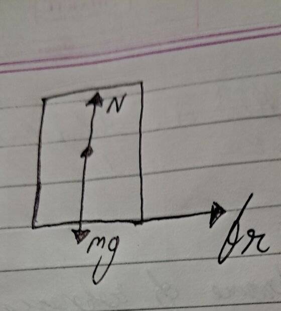

So...here is the problem (I think). Separate the block from the sled and do a FBD of the block. ( Ok never mind, I see you did that).
What is the force of static friction you calculated (I believe this is the point of confusion)?

Force of friction = ma , m is the mass of the block accn is the, a is acceleration of platform as the block and platform are moving together
I get ##a > \frac{g}{2}## w.r.t a frame of reference fixed to the ground by summing the torques about the CM of the block.
In post #11:
The normal force is not applied to the CM. Where would the point of contact be when the box begins to tip?

It's conceptually more difficult in the inertial frame. Note first that torques must be considered about a fixed point in space; not about a point on an accelerating object (*).
As the block accelerates, the angular momentum about an origin (perhaps at the point where the rear of the block begins) is increasing. That requires a torque about that point, which must be provided by ##mg##, as the accelerating force provides no torque about that point. If ##a## is large enough, then ##mg## is not sufficiently large to provide the required torque and the block starts to topple.

Is the shifting of ##N## to the corner of the box a manifestation of the inertial force?

In the non-inertial frame, yes. Any normal force forward of the rear is only adding to the anticlockwise torque in this case. The first thing that happens is that the normal force increases towards the rear, up to a maximum of ##mg##. That's what happens when you stand on an accelerating vehicle: the amount of weight on your back leg increases until that leg bears all your weight.
