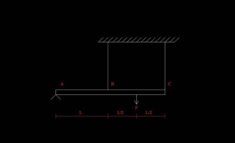

The attachment shows a structure. I'm supposed to calculate the forces in the members B and C. I try the following:
[tex] \sum M _A = BL + 2CL - F \cdot {3 \over 2}L = 0[/tex]
[tex] \sum {F_Y = B + C - F = 0} [/tex]
Solving for B and C from this doesn't yield the correct answer, which is B=3F/10 and C=6F/10.
Can someone explain?

Please post homework problems in the homework help section.
As for your problem, it looks as if point C is free floating. So there is no force developed at C. Hope that solves your worries.
