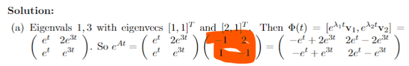

For this problem,
Typed exercise 5(a): compute the fundamental matrix and matrix exponential for the system x' = [[5, -4], [2, -1]] x.
The solution is,
Worked solution showing eigenvector matrix [[e^t, 2e^{3t}], [e^t, e^{3t}]] times matrix [[e^t, 2e^{3t}], [e^t, e^{3t}]] inverse-style factor, with the matrix [[-1, 2], [1, -1]] highlighted in orange, equal to a result matrix containing -e^t + 2e^{3t} and 2e^t - 2e^{3t} entries.
However, can someone please explain to me where they got the orange coefficient matrix from?It seems different to the original system of the form ##\vec x' = A\vec x## which is confusing me.
Thanks!

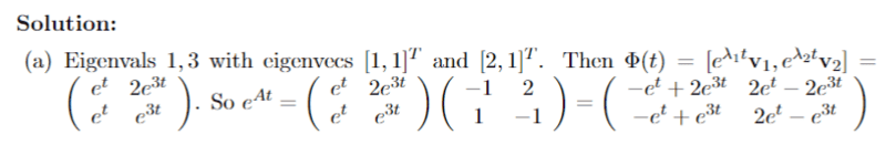

  • Worked solution: eigenvalues 1 and 3 with eigenvectors [1,1]^T and [2,1]^T, fundamental matrix Phi(t) and matrix exponential e^(At) written as 2x2 matrices, followed by the product simplified into a 2x2 result.

This is all about transforming the original matrix A into it's Jordan normal form as the easy way to solve ##e^{At}## (the state transition matrix). But then you have to do the inverse transformation to get it back to the original basis. The reason you find the eigenvectors is to create the Jordan form, which, for simple systems is just a matrix with the e-values on the diagonal.
So, in your case the transform to the Jordan normal form uses the e-vector matrix ##H=
\begin{bmatrix}
1 & 2\\
1 & 1
\end{bmatrix}##
What is it's inverse ##H^{-1}## and how would you use it?
