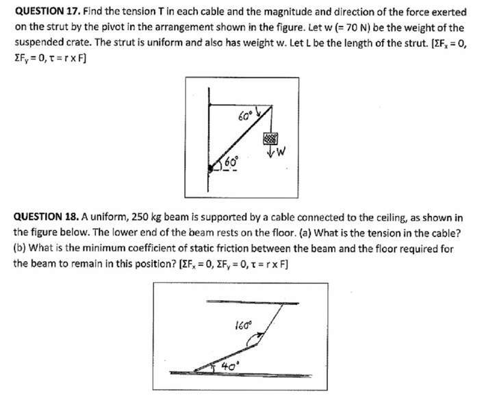

Im having trouble understanding how to find the tension 'T' and pretty much answering the question on the .jpg file i have attached
ƩFx=0, ƩFy=0, τ=r x F
For question 17 i have:
TLsinθ - w(l/2cosθ)-w(Lcosθ)= 0 (*because net sum of torques =0*)
And for question 18 i have no attempts at the question haha.
Help would be much appreciated!
Good. That will give you the tension. What about the other conditions for equilibrium?
Umm i have no idea what are the other conditions of an equilibrium are..
You posted them under "Relevant Equations". :smile:
Sorry for the delayed reply but i have completed number 18 but have not completed 17 (been doing other topics, anyways back this topic).
The next part should be: (But I am not sure how haha)
3.TLsin60-3/2WLcos60 = 0
Show your equations for ƩFx = 0 and ƩFy = 0.
Hint: Label the force components exerted by the pivot as Px & Py. You'll solve for those components, of course.
