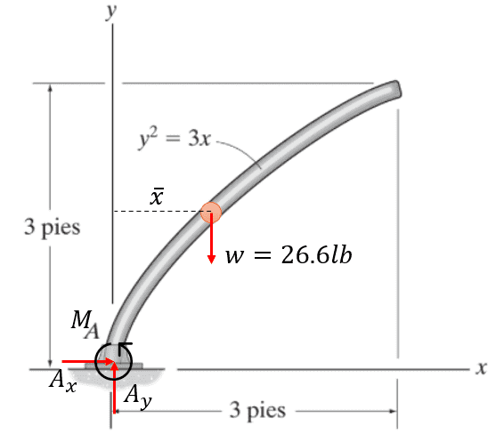

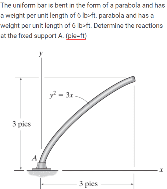

The uniform bar is bent in the form of a parabola and has a weight per unit length of 6 lb>ft. parabola and has a weight per unit length of 6 lb>ft. Determine the reactions at the fixed support A.

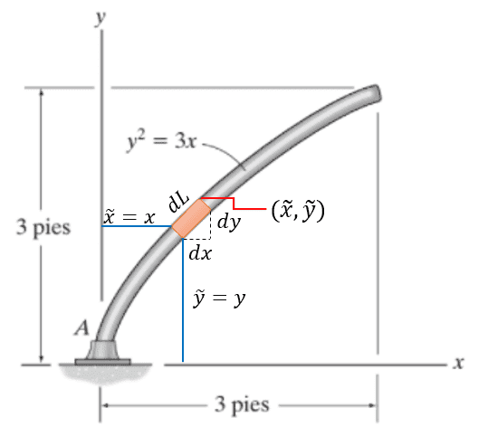

## dL=\sqrt{\left(\frac{dx}{dy}\right)^2+1}dy ##
## \overline{x}=\frac{\int _{ }^{ }\tilde{x}dL}{\int _{ }^{ }dL} ##
My solution is

dL=\sqrt{\left(\frac{dx}{dy}\right)^2+1}dy\\
y^2=3x\\
\frac{y^2}{3}=x\ →\frac{2y}{3}dy=dx\\
\frac{y^2}{3}=x\ →\frac{2y}{3}=\frac{dx}{dy}\\
\overline{x}=\frac{\int_0^3\tilde{x}dL}{\int_0^3dL}\ →\left[\textcolor{#E94D40}{\ dL=\sqrt{\left(\frac{dx}{dy}\right)^2+1}dy}\right]\\
\overline{x}=\frac{\int_0^3\tilde{x}\sqrt{\left(\frac{dx}{dy}\right)^2+1}dy}{\int_0^3\sqrt{\left(\frac{dx}{dy}\right)^2+1}dy}\ →\left[\textcolor{#E94D40}{\ \frac{dx}{dy}=\frac{2y}{3}}\right]\end{array}\\
\overline{x}=\frac{\int_0^3x\sqrt{\left(\frac{2y}{3}\right)^2+1}dy\ →\ \left[\textcolor{#E94D40}{\frac{y^2}{3}=x}\ \right]\ }{\int_0^3\sqrt{\left(\frac{2y}{3}\right)^2+1}dy}\\
\overline{x}=\frac{\int_0^3\frac{y^2}{3}\sqrt{\left(\frac{2y}{3}\right)^2+1}dy\ \ }{\int_0^3\sqrt{\left(\frac{2y}{3}\right)^2+1}dy}\\

w=26.62lb\end{array}><mtable columnalign=left columnspacing=1em rowspacing=4pt><mtr><mtd><mi>D</mi><mi>a</mi><mi>t</mi><mi>a</mi></mtd></mtr><mtr><mtd><mtable columnspacing=1em rowspacing=4pt><mtr><mtd><msup><mrow data-mjx-texclass=INNER><mo data-mjx-texclass=OPEN>(</mo><mi>d</mi><mi>L</mi><mo data-mjx-texclass=CLOSE>)</mo></mrow><mn>2</mn></msup><mo>=</mo><msup><mrow data-mjx-texclass=INNER><mo data-mjx-texclass=OPEN>(</mo><mi>d</mi><mi>x</mi><mo data-mjx-texclass=CLOSE>)</mo></mrow><mn>2</mn></msup><mo>+</mo><msup><mrow data-mjx-texclass=INNER><mo data-mjx-texclass=OPEN>(</mo><mi>d</mi><mi>y</mi><mo data-mjx-texclass=CLOSE>)</mo></mrow><mn>2</mn></msup></mtd></mtr><mtr><mtd><mi>d</mi><mi>L</mi><mo>=</mo><msqrt><msup><mrow data-mjx-texclass=INNER><mo data-mjx-texclass=OPEN>(</mo><mi>d</mi><mi>x</mi><mo data-mjx-texclass=CLOSE>)</mo></mrow><mn>2</mn></msup><mo>+</mo><msup><mrow data-mjx-texclass=INNER><mo data-mjx-texclass=OPEN>(</mo><mi>d</mi><mi>y</mi><mo data-mjx-texclass=CLOSE>)</mo></mrow><mn>2</mn></msup></msqrt></mtd></mtr><mtr><mtd><mi>d</mi><mi>L</mi><mo>=</mo><msqrt><mrow data-mjx-texclass=INNER><mo data-mjx-texclass=OPEN>(</mo><msup><mrow data-mjx-texclass=INNER><mo data-mjx-texclass=OPEN>(</mo><mfrac><mrow><mi>d</mi><mi>x</mi></mrow><mrow><mi>d</mi><mi>y</mi></mrow></mfrac><mo data-mjx-texclass=CLOSE>)</mo></mrow><mn>2</mn></msup><mi>d</mi><msup><mi>y</mi><mn>2</mn></msup><mo>+</mo><mrow data-mjx-texclass=INNER><mo data-mjx-texclass=OPEN>(</mo><mn>1</mn><mo data-mjx-texclass=CLOSE>)</mo></mrow><msup><mrow data-mjx-texclass=INNER><mo data-mjx-texclass=OPEN>(</mo><mi>d</mi><mi>y</mi><mo data-mjx-texclass=CLOSE>)</mo></mrow><mn>2</mn></msup><mo data-mjx-texclass=CLOSE>)</mo></mrow></msqrt></mtd></mtr><mtr><mtd><mi>d<
<math xmlns=http://www.w3.org/1998/Math/MathML display=block data-is-equatio=1 data-latex=\begin{array}{l}↶_+ΣM_A=0\\
M_A-\overline{x}\cdot26.6=0\\
M_A-1.23\cdot26.6=0\\
\left[\textcolor{#E94D40}{M_A=32.72↶_+}\right]\\
\overrightarrow{+}Σfx=0\\
\left[\textcolor{#E94D40}{A_x=\overrightarrow{0}}\right]\\
_+↑Σfy=0\\
A_y-26.6=0\\
\left[\textcolor{#E94D40}{A_y=26.6_+↑}\right]\\
Solutions\\
\left[\textcolor{#E94D40}{A_x=\overrightarrow{0}}\right]\left[\textcolor{#E94D40}{A_y=26.6_+↑}\right]\\
\left[\textcolor{#E94D40}{M_A=32.72↶_+}\right]\end{array}><mtable columnalign=left columnspacing=1em rowspacing=4pt><mtr><mtd><msub><mo>↶</mo><mo>+</mo></msub><mi>Σ</mi><msub><mi>M</mi><mi>A</mi></msub><mo>=</mo><mn>0</mn></mtd></mtr><mtr><mtd><msub><mi>M</mi><mi>A</mi></msub><mo>−</mo><mover><mi>x</mi><mo accent=true>―</mo></mover><mo>⋅</mo><mn>26.6</mn><mo>=</mo><mn>0</mn></mtd></mtr><mtr><mtd><msub><mi>M</mi><mi>A</mi></msub><mo>−</mo><mn>1.23</mn><mo>⋅</mo><mn>26.6</mn><mo>=</mo><mn>0</mn></mtd></mtr><mtr><mtd><mrow data-mjx-texclass=INNER><mo data-mjx-texclass=OPEN>[</mo><mstyle mathcolor=#E94D40><msub><mi>M</mi><mi>A</mi></msub><mo>=</mo><mn>32.72</mn><msub><mo>↶</mo><mo>+</mo></msub></mstyle><mo data-mjx-texclass=CLOSE>]</mo></mrow></mtd></mtr><mtr><mtd><mover><mo>+</mo><mo>→</mo></mover><mi>Σ</mi><mi>f</mi><mi>x</mi><mo>=</mo><mn>0</mn></mtd></mtr><mtr><mtd><mrow data-mjx-texclass=INNER><mo data-mjx-texclass=OPEN>[</mo><mstyle mathcolor=#E94D40><msub><mi>A</mi><mi>x</mi></msub><mo>=</mo><mover><mn>0</mn><mo>→</mo></mover></mstyle><mo data-mjx-texclass=CLOSE>]</mo></mrow></mtd></mtr><mtr><mtd><msub><mi/><mo>+</mo></msub><mo stretchy=false>↑</mo><mi>Σ</mi><mi>f</mi><mi>y</mi><mo>=</mo><mn>0</mn></mtd></mtr><mtr><mtd><msub><mi>A</mi><mi>y</mi></msub><mo>−</mo><mn>26.6</mn><mo>=</mo><mn>0</mn></mtd></mtr><mtr><mtd><mrow data-mjx-texclass=INNER><mo data-mjx-texclass=OPEN>[</mo><mstyle mathcolor=#E94D40><msub><mi>A</mi><mi>y</mi></msub><mo>=</mo><msub><mn>26.6</mn><mo>+</mo></msub><mo stretchy=false>↑</mo></mstyle><mo data-mjx-texclass=CLOSE>]</mo></mrow></mtd></mtr><mtr><mtd><mi>S</mi><mi>o</mi><mi>l</mi><mi>u</mi><mi>t</mi><mi>i</mi><mi>o</mi><mi>n</mi><mi>s</mi></mtd></mtr><mtr><mtd><mrow data-mjx-texclass=INNER><mo data-mjx-texclass=OPEN>[</mo><mstyle mathcolor=#E94D40><msub><mi>A</mi><mi>x</mi></msub><mo>=</mo><mover><mn>0</mn><mo>→</mo></mover></mstyle><mo data-mjx-texclass=CLOSE>]</mo></mrow><mrow data-mjx-texclass=INNER><mo data-mjx-texclass=OPEN>[</mo><mstyle mathcolor=#E94D40><msub><mi>A</mi><mi>y</mi></msub><mo>=</mo><msub><mn>26.6</mn><mo>+</mo></msub><mo stretchy=false>↑</mo></mstyle><mo data-mjx-texclass=CLOSE>]</mo></mrow></mtd></mtr><mtr><mtd><mrow data-mjx-texclass=INNER><mo data-mjx-texclass=OPEN>[</mo><mstyle mathcolor=#E94D40><msub><mi>M</mi><mi>A</mi></msub><mo>=</mo><mn>32.72</mn><msub><mo>↶</mo><mo>+</mo></msub></mstyle><mo data-mjx-texclass=CLOSE>]</mo></mrow></mtd></mtr></mtable></math>
However can someone explain in detail why
will be equal to the weight? and why does it have to be multiplied by 6?
The integral is length of the bar multiplied by weight per unit length of 6 lb>ft so should be equal to weight of bar in lb. I do not see if it equals to ##\bar{x}## which I do not catch its definition.
##\bar{x}## should be the x coordinate of the centroid. I can't see anywhere in the image that equates that to w or to the integral expression for w.
