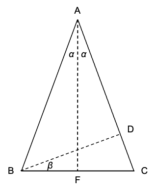

kuruman said:
Here is what I had in mind. The diagram is drawn to scale specifically for this problem but the proof is general because the proposition that we are asked to prove is an identity.
  1. Draw isosceles triangle ABC.
  2. Draw heights AF and BD.
  3. From right triangle ADB we have ##BD = AB \sin(2\alpha).##
  4. From right triangle AFB BDC we have ##BD = BC \cos(\beta).##
  5. It follows that ##AB \sin(2\alpha)=BC \cos(\beta).##
  6. Angles ##\alpha## and ##\beta## are equal because their sides are mutually perpendicular. Therefore, ##BC \cos(\alpha)=AB \sin(2\alpha).##
  7. Setting ##\alpha = \frac{\theta}{2}##, ##AB=10## and ##BC=7## finishes the proof for this specific case.
Sorry, for step no. 6, what is the meaning of "their sides are mutually perpendicular" ?
Thanks
Thanks
Angle ##\alpha## (right) is formed by segments AF and AC.
Angle ##\beta## is formed by segments BD and BC.
BD is perpendicular to AC and BC is perpendicular to AF. That's what "mutually perpendicular" means. You can see that the sides will be parallel to each other when you rotate AF and AC counterclockwise by 90° which makes the angles equal.
Thanks
Alternatively: Notice that triangle AFC and triangle BDC are similar, so ##\alpha = \beta ## .

It seems to me that ##\cos(\frac{\theta}{2})=0## is not a solution to a particular equation. The identity $$2\cos(\frac{\theta}{2})\sin(\frac{\theta}{2})=\sin(\theta)$$can be derived geometrically from the triangle ABC in post #30 shown slightly modified below.
We have
  1. ##(BC)=2(BF)=2(AB)\sin(\alpha)\implies (BC)\cos(\alpha)=2(AB)\sin(\alpha)\cos(\alpha)##
  2. ##(BD)=(AB)\sin(2\alpha)=(BC)\cos(\alpha)##
From 1 and 2 it follows that $$(AB)\sin(2\alpha)=2(AB)\sin(\alpha)\cos(\alpha)\tag{1}$$which proves the identity. Being an identity means that it is not an equation to be solved and that it has no roots. It means that if you put any specific value of ##\alpha## in each side and evaluate separately, you get ##LHS=RHS##. That's not how equations with roots behave.
