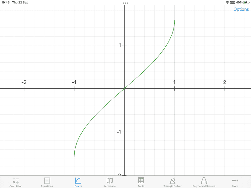

Iterate on your calculator $$\theta = sin^{-1}\left(\frac{7}{10} cos(\frac{\theta}{2})\right)$$ until it converges.

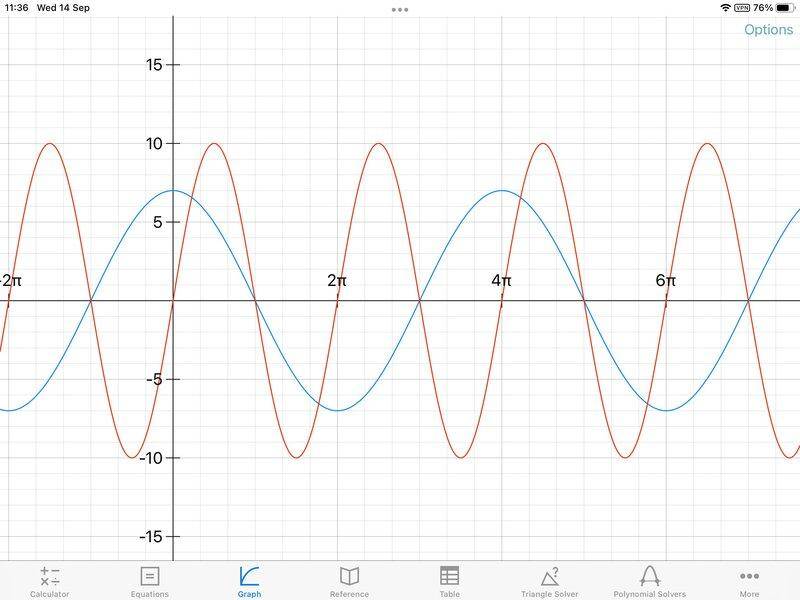

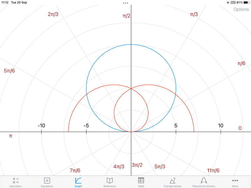

There are three solutions 0 ≤ θ ≤ 2π . One of them you can obtain as indicated in #16 (and you may kick yourself if you have missed it).
Actually the periodicity of the problem is 4π not 2π (Another reason for doubt as to whether the Prof who set it knew exactly what he's about) and there are two of these 'trivial' solutions, and still only two others 0 ≤ θ ≤ 4π , I think.

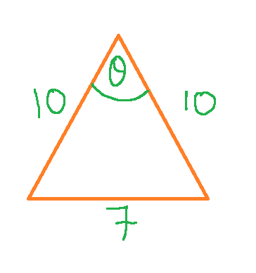

By both methods, do you mean the methods in post #19 and post #22?
If yes, for the method in post #19:
$$7 \cos \left(\frac{\theta}{2}\right)=10 \sin \theta$$
$$\frac{7}{\sin \theta}=\frac{10}{\cos \frac{\theta}{2}}$$
$$\frac{7}{\sin \theta}=\frac{10}{\sin \left(\frac{\pi}{2}-\frac{\theta}{2}\right)}$$
This is in the form of sine rule and then I changed it into triangle diagram to get the same picture as post#19
Solving the cosine rule, I got 0.72 and 5.57 as the solution. I got the third solution by using your method in post #16For the method in post #22, I used the double angle formula (which is maybe prohibited by my teacher):

What I did was only change sine rule into triangle:
Side of length 7 will be across the angle ##\theta## and side of length 10 will be across angle ##\frac{\pi}{2} - \frac{\theta}{2}##. One more angle of the triangle will be ##\frac{\pi}{2} - \frac{\theta}{2}## so the triangle is an isosceles triangle and the third side will also be 10.

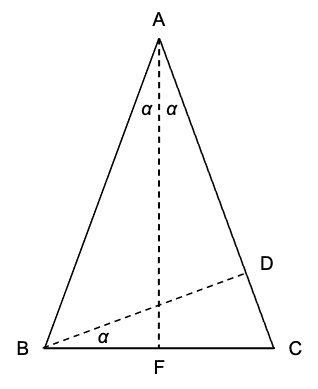

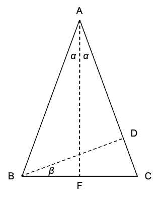

Here is what I had in mind. The diagram is drawn to scale specifically for this problem but the proof is general because the proposition that we are asked to prove is an identity.
  1. Draw isosceles triangle ABC.
  2. Draw heights AF and BD.
  3. From right triangle ADB we have ##BD = AB \sin(2\alpha).##
  4. From right triangle AFB BDC we have ##BD = BC \cos(\beta).##
  5. It follows that ##AB \sin(2\alpha)=BC \cos(\beta).##
  6. Angles ##\alpha## and ##\beta## are equal because their sides are mutually perpendicular. Therefore, ##BC \cos(\alpha)=AB \sin(2\alpha).##
  7. Setting ##\alpha = \frac{\theta}{2}##, ##AB=10## and ##BC=7## finishes the proof for this specific case.
