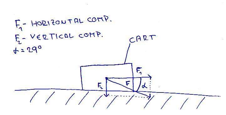

i have this one problem in my homework tht i cannot solve:
A person pushes a 16kg cart at a constant velocity for a distance of 22.0m. She pushes in a direction 29 degrees below the horizontal. A 48 N frictional force opposes the motion of the cart. a) what is the magnitude of the force that the shopper exerts? b) determine the work done by the pushing force.
please guide me or show me the steps

It's always better to make an attempt at the solution. Heard anything of decomposition of forces? Since the velocity is constant, the horizontal (tangential) component of the person's force is equal in magnitude and opposite in direction to the frictional force.
ad a) Make a drawing and then use trigonometry to get the total force the shopper exerts.
ad b) Hope you know the definition of work, force * distance. Don't forget what force to calculate with. Is it the total force or just the horizontal (tangential) component?
i have already made the drawing
however i am not sure how to separate it into its components
also how do you mathematically express the horizontal component to the frictional force?
and for part b it is just the horizontal component
ty
Well, it should be apparent from the drawing, so post it here and let us see what you've made so far.
And yep, it's just the horizontal component (the component in the direction of the motion) that's used when calculating work.
i kno tht the horizontal component is fcos29
however i don't seem to be able to get to the force
im completely lost
ty
Vertical and horizontal components of the total force form a rectangle. The total force is its diagonal - the angle between the horizontal force and the total force is 29 degrees. Everything else stems from this drawing.
