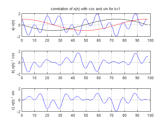

To obtain the frequency information from the time domain signal, I've to apply filters and observe the results. These filters are harmonic frequencies, one at time. So I've to compare, one by one, the basis signals (harmonics) with the time domain signal to see how much correlation there is.
Each harmonic has to be compared in two ways: comparing the real part (cosine) and comparing the imaginary part (sine) of that harmonic with the time domain signal. A high correlation means that when the time domain signal is positive, the harmonic is also positive and when it's negative the harmonic is also negative. The cosine correlation has a result a real number. The sine correlation has a result an imaginary number. The real + imaginary number is a complex number. Well, the absolute value of that complex number in a given point, is the magnitude of the specific spectrum. All this is right?
Time domain signal
Cosine
Sine
One of the parts I don't understand is after performing the correlation. The result is the above graph and I've to obtain a number from that graph. How can I obtain the correlation value using that graphic? For example, if I've to obtain the sine correlation number, how can I get that number from the graphic?

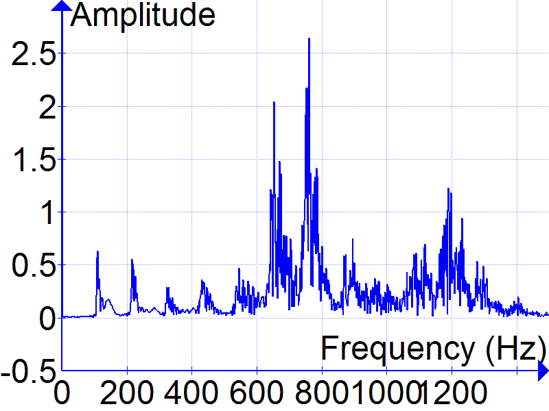

What is the sample rate (or time step)?
I had to assume a sample rate of 44100 samples per second to meaningfully compute the FFT in sensible units (frequency in Hz).
The graph is shown below. If my guess at the sample rate is right, the sound is a musical A note with a fundamental frequency of 110 Hz and lots of overtones, possibly due to distortion, possibly due to an instrument with lots of overtones. The output fft is also attached as a text file (amplitude vs. frequency). The third column in the file is phase (in radians).
There is a strong temptation in the fft world to neglect the independent variable. This is a dangerous practice when interpreting the physical meaning of Fourier transforms. When you get your fft code written properly, your output should look the same, give or take a multiplicative constant for the amplitude as well as a possible horizontal stretch if I guessed wrong at the sample rate. Note that the fft returns data out to a frequency of 0.5 times the sample rate. The outout data is there, but there is little in terms of meaningful features.
Sorry, the sample rate is 44100 Hz
Yes, the same rate is 44100 samples per second (sorry about the reply. I wasn't connected). The sound is human voice saying the letter 'A' all the time. Thanks for the text file.
