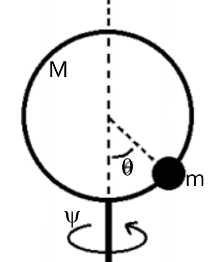

Consider a mechanical system
Diagram of a bead on a rotating hoop: a circle of mass M on a vertical axis, a bead of mass m on its rim at angle θ from the bottom-to-top vertical, and a rotation arrow labelled ψ about the axis.
A circle of mass M can rotate about the vertical axis. The angle of rotation is coordinated by the angle ##\psi##. A bead of mass m>0 can slide along this circle. The position of the bead relative the circle is given by the angle ##\theta##.
It is interesting to note that if M>0 the Lagrangian of this system is defined on the tangent bundle ##T\mathbb{T}^2##. But if M=0 then the Lagrangian is defined on the tangent bundle ##TS^2##.
##\mathbb{T}^n=S^1\times\ldots\times S^1,\quad \mathbb{T}^1=S^1##
but
##S^1\times S^1\ne S^2##!
