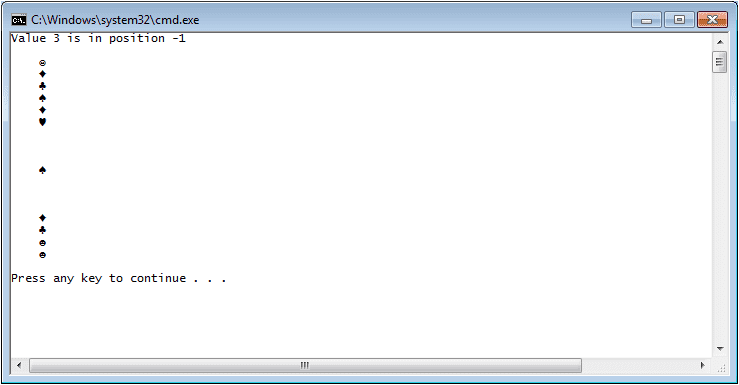

This screenshot attached is for a question further down the assignment. Due to a datatype mismatch instead of printing an array it beeped three times and printed this...

It seems like it just printed some byte values, but I can't discern much more without some more details.
Oh, that screenshot is from the next question down. :p
