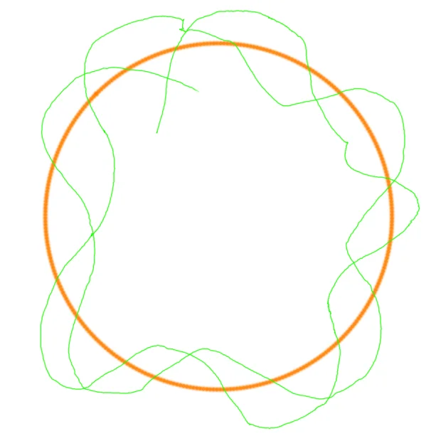

Here's an orange circle with a green wave:
Diagram of a solid orange circle with a green wavy line around it, the green line crossing in and out of the circle with six complete oscillations around the circumference.
In places the green wave is outside the orange circle, in places it's inside. You can think of the orange circle as an undisturbed sun and the green shape as the sun with a (very low frequency) sound wave disturbing it. (Do note that sound waves are longitudinal and I've drawn a transverse wave, but longitudinal waves are really hard to sketch. So this isn't quite accurate, but the important features are here.)
Notice that there are six complete waves in the diagram. This is the kind of wave Tegmark is describing as "a whole number of oscillations as it goes around".

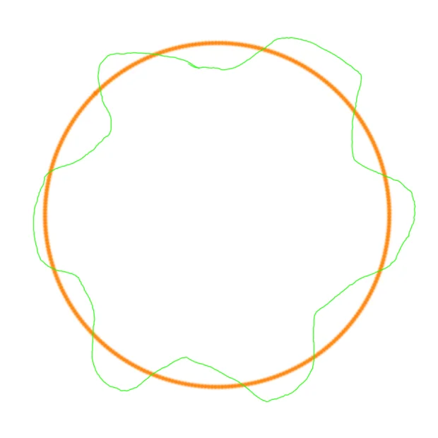

Now here's a version of the diagram where the wave doesn't do a whole number of oscillations:
Diagram of a green wavy line that repeatedly crosses in and out of an orange circle, with six complete oscillations going around the circle.
This time, I've picked a wavelength that doesn't evenly divide the circumference of the circle, so it doesn't meet itself. In terms of a wave, that means that if it wraps round the sun it is both trying to push the surface up and push it down at any one place. Averaged over a few laps, the "up" and "down" motions cancel each other out and the wave dies out rather than reinforcing itself.
I have to say that I'm not sure Tegmark is helping here. What he is describing is actually something quite familiar, but in an unfamiliar setting and in a rather abstract way. You know you can tap a bell and it rings, and different size bells ring with different tones because bells resonate at particular frequencies, right? It turns out to be true of anything that's free to move, like wine glasses and bowls, but also the earth and the sun. That's what he's describing - the Sun vibrating like a bell at its resonant frequency (although in this case, driven by its own internal energy sources rather than Thor passing by with his hammer).
It turns out that the resonant frequency of a sphere is related to the frequency of sound waves whose wavelengths exactly divide the circumference of the object - because other wavelengths cancel themselves out quickly as they wrap around (as in my second diagram). It also turns out that any disturbance of the surface can be split up (mathematically, anyway) into a little bit of the wave that fits once plus a little bit of the wave that fits around twice plus a little bit of the wave that wraps around three times plus... Taking advantage of this fact applied to normal sound waves (instead of waves on spheres) is how spectrum equalizers on fancy hi-fi systems work - they split out the low, middle, and high frequencies making up a single sound and let you amplify them (or not) separately before recombining them with stronger bass or whatever.
