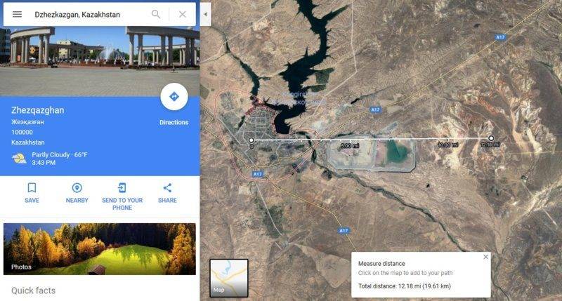

NASa says the Soyuz landed about 20 kilometers east of Dzhezkazgan, Kazakhstan, and reiterates the two men onboard are in good condition.
Looks like pretty hilly terrain. Glad that they're safe.
Google Maps screenshot of Zhezqazghan, Kazakhstan, with the left panel showing a place card and photos, and a satellite map on the right with a measured straight-line distance of 12.18 mi (19.61 km) between two points.
  • Google Maps screenshot of Zhezqazghan, Kazakhstan, with the left panel showing a place card and photos, and a satellite map on the right with a measured straight-line distance of 12.18 mi (19.61 km) between two points.

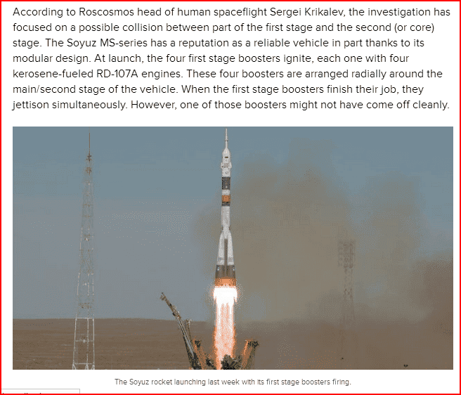

Roscosmos reveals cause for Soyuz launch failure: http://tass.com/science/1025675
Their provisional conclusion is that one of the four strap-on boosters impacted the core second stage during separation, causing the lower part of the second stage to disintegrate (presumably it pierced the tanks), triggering an automatic abort.
Of course, they still have to identify the cause of the impact. So far they have suggested that a problem with the separation mechanism might have prevented the booster from separating cleanly.
Although the event occurred while the video feed was showing inside the cabin, a subsequently released photo showed a large cloud that formed abruptly around separation time. When the external video was resumed, that cloud was dissipating and the strap-on boosters could be seen spinning away, but they were not in the usual neat "Korolev cross" and there were clearly several more separately visible parts than expected for four boosters (and perhaps the escape tower) in addition to the continuing second stage core.
The voice-over on the video suggested that the escape tower had been jettisoned normally just before that point. Some news articles suggest that the escape tower system was involved in the automatic abort process, but I suspect that was a misunderstanding.
