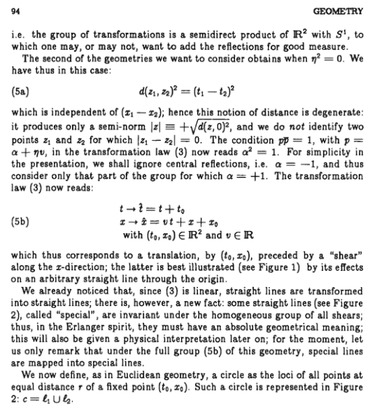

PeterDonis said:
There is no "distance through spacetime" in Newtonian physics, because there is no spacetime metric. @Ibix is not talking about ordinary distance through space.
There is a metric (the degenerate Galilean metric in Cayley-Klein Geometry) that can assign a distance to timelike curves:
[tex]ds^2 =dt^2[/tex],
which is a special case of
[tex]ds^2 =dt^2 - \frac{c^2}{c_{max}^2}\frac{dx^2}{c^2}[/tex].
Those interested can revisit this discussion
https://www.physicsforums.com/threads/going-from-galilei-to-minkowski.930035/post-5871574 (especially here https://www.physicsforums.com/threads/going-from-galilei-to-minkowski.930035/post-5872323 )
By the way, I first learned of this notion from a chapter in Emch's book (see reference below),​
then found that it appears in the relativity literature (as given in links in the previous discussion).​
Mathematical and Conceptual Foundations of 20th-Century Physics​
By G.G. Emch (2000)​
look up "Cayley" and advance to page 94;

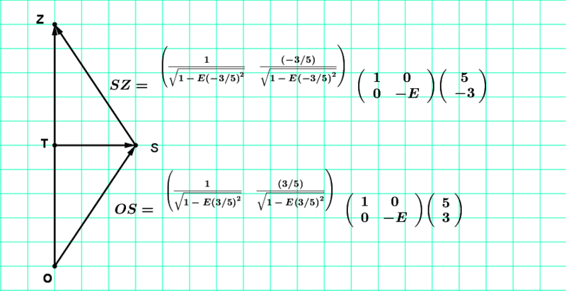

For completeness, I provide the following unified construction
to assign an "arc-length" to timelike paths [here, composed of displacements in a vector space],
whose numerical value is determined by a real parameter [itex]E[/itex],
which can take values
  • (-1 ) for Euclidean geometry
  • ( 0 ) for Galilean spacetime geometry, and
  • (+1) for Minkowski spacetime geometry
The construction essentially counts the number of "unit vectors" along each displacement,
where the "unit vector" is determined by the "slope" [of the displacement] (an affine concept)
and the value of [itex]E[/itex] in that matrix.
I'm not going to worry about terminology or generality (e.g. applying to other curves).
I'm just doing what I've claimed is possible:
using metrical information (provided somehow) to assign an arc-length to a
timelike curve between two fixed point-events
which suggests that the notion of proper time (wristwatch time) that Minkowski developed
when he formulated the "spacetime viewpoint"
applies to the Galilean spacetime in the analogous way given here.
For the Euclidean case, this is like an odometer carried by the surveyor reading the distance traveled along that path.
For the Galilean and Minkowski cases, this is like a wristwatch carried by the astronaut reading the proper-time elapsed along that worldline.
[I have omitted the calculation for OT=5 and TZ=5, using the given grid and the affine structure.]
The key point is that without further metrical structure (provided somehow),
there is no specific assignment of the magnitudes of the vectors [itex]\vec{OS}[/itex] and [itex]\vec{SZ}[/itex] that are not along the given grid.

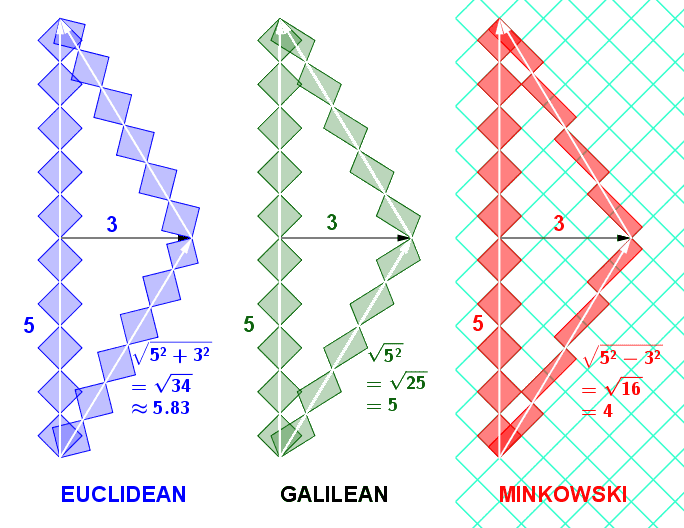

So, we have, for this triangle with legs 5 and 3 on the given grid,
  • for [itex]E=-1[/itex], we have [itex]OS=\sqrt{34}[/itex] and [itex]SZ=\sqrt{34}[/itex],
    essentially leading to the triangle-inequality for Euclidean space
  • for [itex]E=0[/itex], we have [itex]OS=5[/itex] and [itex]SZ=5[/itex],
    essentially leading to the "no clock-effect" ... absolute time for Galilean spacetime geometry
  • for [itex]E=+1[/itex], we have [itex]OS=4[/itex] and [itex]SZ=4[/itex],
    essentially leading to the reverse triangle-inequality ... the clock effect for Minkowski spacetime geometry
Borrowing from an old diagram in an old post,
these results can be visualized as
...where the "diamonds with vertical diagonals along the verticals" are analogous to the usual rectangular grid boxes
and the "diamonds with diagonals along the OS and SZ displacements" are the results of a Euclidean rotation or Galilean or Lorentz boost of the original diamonds-with-vertical-diagonals, corresponding to the value of E.
These diagrams are just a representation of the calculation.
the magnitudes of the vectors OS and SZ (not parallel to the given grid lines)
are determined by the specification of the value of E, as given above.
(This is in the spirit of the Cayley-Klein geometry framework referenced earlier.)
