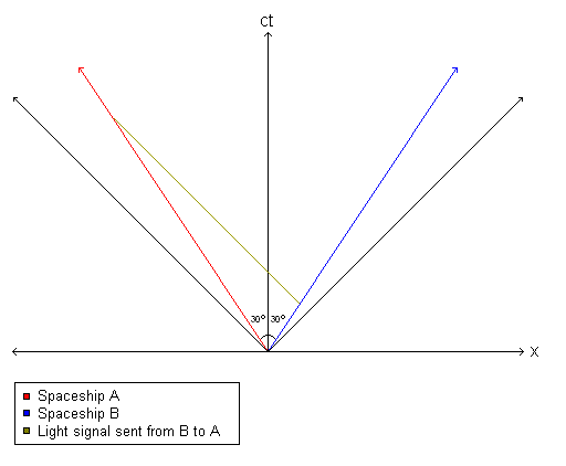

Is it safe for me (the observer that sees each ship moving in opposite directions at 0.75c) to say that they're moving away from each other at a speed greater than c?
I made the space-time diagram and see no problems with this affirmation, hope you can check it out and tell me if there's anything wrong with it :P
The ships are moving away from each other with an angle of 60° (greater than 45°, which to my understanding would mean they're moving away from each other at c.). Of course I understand that if we rotate the diagram using Lorentz transformations to see how the same situation looks using spaceship A as the reference frame spaceship B's line would not be at an angle greater than 45° from spaceship A's line.

nevermind that last post, I just read ht tp://math.ucr.edu/home/baez/physics/Relativity/SpeedOfLight/FTL.html and confirmed what I thought :P
