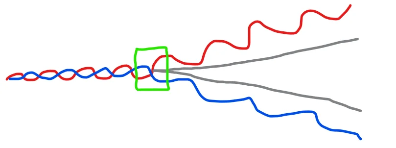

I drew this image to better illustrate my question:
The red and blue would be the entangled particles, the gray, the preparation, and the green box points to the origin of the entangled pair at the preparation.
From my current understanding, the QM formalism does not seem to imply that preparation is followed by a complete physical separation of the entangled subsystems.
It establishes their distinguishability and allows their spatial separation, while the state itself remains joint and nonfactorizable.
My question is whether treating that spatial/dynamical separation as a complete physical independence could be precisely what creates the posterior “spooky” necessity to somehow reestablish a correlation that may never have been physically broken in the first place.

aletheia said:
Quite the contrary — that’s exactly the core of my question: why spatial separation and distinguishability should imply complete independence?
By "independence" here, do you mean statistical independence of measurements? In analyzing an argument such as EPRs, it is best if we stick to clear, well defined, and well scoped terminology.
For example, when EPR says "no longer any interaction", they don't mean measurements of the two particles will be statistically independent. Quite the contrary, their whole argument relies on perfect (anti) correlation.
aletheia said:
Maybe the error was to treat the disappearance of a direct interaction as implying complete physical independence, even though the entangled state itself remains joint.
Again, "complete physical independence" -- I don't know what (precisely) you mean by this.
EPR certainly understood that the entangled state persisted even after time ##T##. They need it for the rest of their argument.
But what they had in mind was to resolve the problem via some local hidden variables. Indeed, their entire argument was that the QM description of physical reality is incomplete (hence their title).
Local hidden variable theories were proven impossible later, as I noted in post #11.

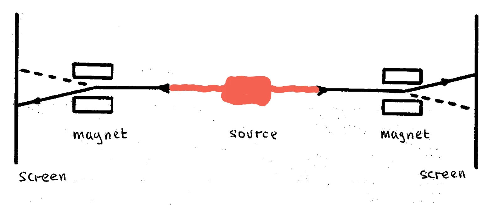

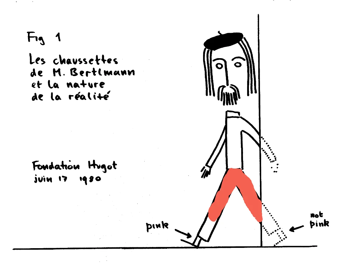

@Matterwave @bhobba
From the Bertelsmann’s Socks and the Nature of Reality we have two useful images that I have edited to better illustrate my question.
First:
brings the assumption that at the preparation both particles are physically separated — meaning that they would have lost their previously joint state —, each of them as a complete whole on their own, which it seems (to me at least) an inference that both the experiments and the QM formalism don’t entitle.
Next we have
the questioning that EPR was advocating — that was later disprove by Bell’s inequality —, that both socks had to had their state predetermined before the measurement of any of them, as if knowing that one sock was pink that the other sock would be not-pink, therefore already having its own color already determined independently of the measurement of the other.
However, there might have been a premisse not fully investigated (at least I couldn’t find it anywhere).
Using the socks analogy: perhaps, if the particles still share their initial root, both of them would still “have the same color” (at least their shared state would still be “pink”) until one of them is measured — the moment which their bond is finalized ontologically —, leaving the other particle with both the consequences of their initial rooted state plus the physical separation.
Summarizing the analogy: the case is not that one sock was pink and the other was not pink, but rather that both were pink and at the measurement one is discovered as red leaving the other as white.
aletheia said:
First:
The figure is just a figure. It doesn't make any assumptions. It just shows you what the experiment is and what happens.
aletheia said:
Next we have
I'm unclear on what the highlighting of the pants means. The analogy is about socks.
Strictly speaking, Bell's inequalities didn't disprove local hidden variable (LHV) theories. They just put a bound on particular combinations of correlations of specific measurements of pairs of particles that any LHV theory must obey under a mild assumption of statistical independence of measurements.
It is only the later experimental proof that those inequalities are violated by nature that local hidden variable theories were disproved (barring any loopholes).
We usually call a theory such as this a LHV theory. It is what Einstein had in mind to avoid spooky action at a distance.
