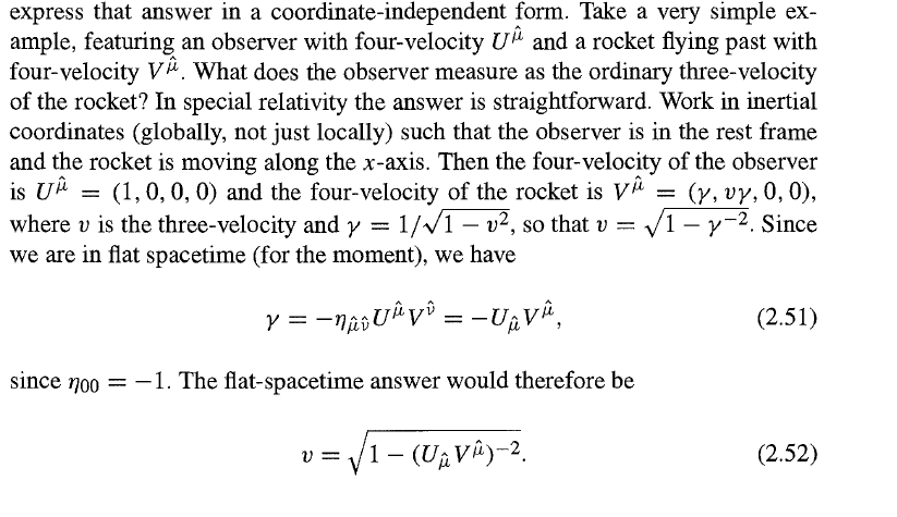

There is a print just below
\n
I am a little confused with the text above. Actually, all is ok until 2.51, i think i am missing something.
What is this? Another way to define gamma? (The doubt is not about the raising indices, neither about "n00 = -1", is just where does the equation came from. That is, the equation is easy to understand, but i don't know from where this come from)
Herculi said:
Homework Statement:: There is a print just below
Relevant Equations:: \n
Equation 2.51 is simply highlighting that ##-\gamma## equals the inner product of the two four vectors. It's easy to work out.
By noticing this you have ##\gamma## (and hence ##v##) expressed in a manifestly covariant form. As the inner product is independent of coordinates, this is useful for generalising toall coordinate systems and to curved spacetime.
It might be helpful to consider the Euclidean version of (2.51).
[itex]\gamma_{euc}=\hat U \cdot \hat V =\cos\theta_{\scriptsize{\rm between\ U\ and\ V}}<br /> =\displaystyle\frac{1}{\sqrt{1+\tan^2\theta_{rel}}}<br /> =\displaystyle\frac{1}{\sqrt{1+m_{rel}^2}}[/itex]
(2.51) interpreted with rapidities (and the [itex](-,+,+,+)[/itex] signature)
[itex]\gamma=-\hat U \cdot \hat V =\cosh\phi_{rel}<br /> =\displaystyle\frac{1}{\sqrt{1-\tanh^2\phi_{rel}}}<br /> =\displaystyle\frac{1}{\sqrt{1-v_{rel}^2}}[/itex]
