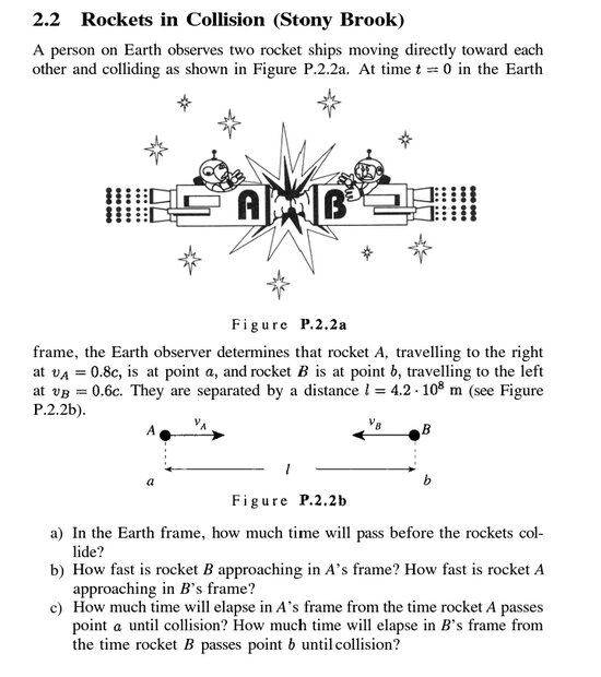

Consider an observer on Earth (Neglect any effect of gravity). Call him A. Let 2 rockets be moving in opposite direction along x-axis (x-axis coincides with the x-axis of A) with uniform velocities. Call them B and C. At t=0, in A's frame, the rockets are separated by length ##l## . Let ##V_a## and ##V_b## be there respective velocities. Calculate the time elapsed from t=0 to the time when B and C collide in the refrance frame of A. What is time elapsed according to B?
Attempt:
It is easy to calculate time elapsed according to A. It is given by:
$$t=\frac{l}{V_a+V_b}$$
It is also easy to calculate time elapsed according to B. It is just dilated time calculated above:
$$t_b=t/\gamma$$
However, I was thinking on how to explain the above result (time elapsed on the clock of B) according to B himself. The relative velocity of C w.r.t B is:
$$V_{rel}=(V_a+V_b)/(1+V_aV_b/c^2)$$
Now, the length between B and C as observed by B is given by length contraction:
$$l_b=l/\gamma$$
The time elapsed on the clock of B is therefore:
$$t_b=l/(\gamma V_{rel})=l/(\gamma( V_a+V_b)/(1+V_aV_b/c^2)$$
This does not matches with the time elapsed calculated above using Time dilation formula. What am I missing?

The question was taken from the book A Guide to Physics Problem, Vol-1, Mechanics, Relativity, Electrodynamics by Cahn and Nadgorny. This is just 2nd question under Relativity section. The question to find the time elapsed in the reference frame of B was not asked but I thought about that question. I am attaching the Screenshot of the Problem
Ok - that question is answerable. Your paraphrase is not. That's why it's important to state the question exactly.

First, from the frame of Earth observer (whom I called A):
Event 1: t=0, Coordinates of Rocket B=0 (Only X-Coordinates as the problem is 1D), Coordinates of Rocket C= ##l##
Event 2: t=##l/(V_a+V_b)##, coordinates of B= ##V_al/(V_a+V_b)##, coordinates of C=##l(1-V_a/(V_a+V_b))##
From the frame of Rocket B:
Event 1: Coordinates of Rocket C= ##l/\gamma## (See Post 6) (Edit: This is wrong!), t=0 (We assume that Clock of Earth observer and Rocket observer are initially Synchronised at the origin)
Event 2 (Collision): Coordinates of C= 0, t=?
Is this correct?

The way I would solve this is to use frame independent invariants.
We have three frames, the Earth frame, A's, frame, and B's frame.. So we need some notation, perhaps unprimed for Earth, primed for A's frame, and double primed for B's frame.
We need to find the time and space coordinates of all the events in the Earth's frame to proceede. The events will be left, collision, and right.
I'll leave you to work those out in terms of the problem parameters, I'll just generalize the point I'm making.
Earth frame, left event. t=0, ##x=x_{left}##
Earth frame, middle (collision) event. ##t=t_{collide}##, ##x=x_{collide}##
Earth frame, right event. t=0, ##x=x_{right}##
It's your choice what spatial coordinates to use in the unprimed Earth frame. One can make a case for setting the spatial coordinate of the collision event equal to zero, in which case ##x_{left} < 0## and ##x_{right} > 0##. But you might also want to make the coordinate of the left event 0. It's up to you. It won't matter to the end answer.
The main thing you haven't worked out yet is the collision point's spatial coordinate.
The invariant space-time interval between the left event and the collision event as expressed in the Earth frame is
$$c^2 \Delta t^2 - \Delta x^2$$
where
$$\Delta t = t_{collision}-0 \quad \Delta x = x_{collision} - x_{left}$$
This must equal the invariant interval between the left event and the collision event in A's frame, which we are representing in the prime frame:
$$c^2 \Delta t'^2$$
because in A's (primed) frame, the x-coordinate of A is always zero.
This application of the invariant space-time interval allows you to solve for the time in A's (primed) frame, ##\Delta t'##. If your textbook doesn't discuss invariants, you might want to provet, using the Lorentz transform, first that
##c^2 t^2 - x^2 = c^2 t'^2 - x'^2##. This shows that the invariant interval between the points (0,0) and (t,x) is constant. It's a small step to generalize from the invariance of this quantity between the origin and any point to the invariance of this quantity between any two points by noting that nothing in the formula is dependent on the choice of the coordinate origins.
It's not strictly necessary, but you might want to apply the Lorentz transform to work out explicitly t and x in the primed frame (A's frame) and the double primed frame (B's prime) to gain some insight.
If you do so, the relativity of simultaneity is shown by the fact that in general, ##t_{left}=0## does NOT mean that ##t'_{left}=0## and ##t''_{left}=0##. Details on what ##t'_{left}## and ##t''_{left}## are will depend on the details of your coordinate choices, though.

Time dilation means that in frame S, A's clock appears to run slower, while in frame S', the Earth clock seems to run slower.
You may also want to work things out from the perspective of rocket B - the concepts will be the same, but the numbers slightly different since B is moving in the opposite direction (sign differences in the velocity) and has a different speed.
There are also graphical techniques you can use using light clocks if you don't like doing all the math. But that does requires you to be comfortable with drawing and interpreting the space-time diagram of a light clock, and also comfortable with light clocks, for that matter. The Lorentz transform method requires you to be comfortable with the approach of assigning coordinates, transforming them, then interpreting the physical picture given the coordinates.
If you think you are more comfortable with drawing and interpreting diagrams than assigning coordinates, doing the math to transform them, then interpreting these coordinate results, there's a paper by one of our PF posters, robphy that I rather like, "Relativity on Rotating Graph paper". The preprint version is available at https://arxiv.org/abs/1111.7254, as far as I know the published version, which is slightly different, is still paywalled. He also has an insight article on PF, I believe.
You don't necessarily have to limit yourself to one approach, but you need to see at least one approach through to the end to gain understanding. Which approach appeals to you more is up to you, along with possibly changing your mind and/or spending the time to learn both.
