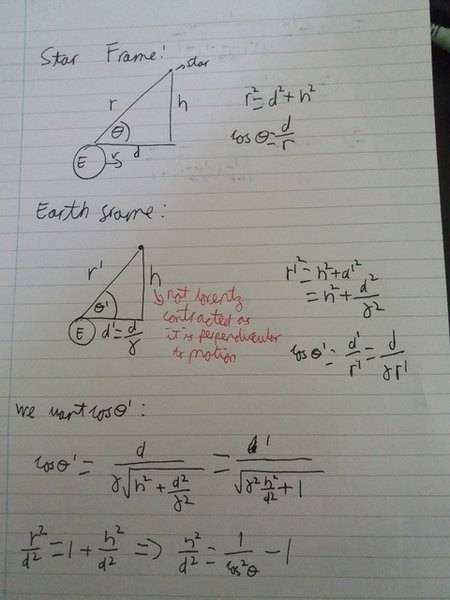

Handwritten notes deriving cos θ' in special relativity: a star-frame triangle with hypotenuse r, adjacent d and height h, and an Earth-frame triangle with contracted adjacent d' = d/γ, with the note 'not Lorentz contracted as it is perpendicular to motion' and the final relation h²/d² = 1/cos²θ − 1.

I have all the quantities but the algebra doesn't seem to work out.

However what was wrong with my method? I understand why your way works, but why didn't mine?
Toby_phys said:
wow, that was soo easy. Thank you.
There's a relativity of simultaneity issue that you missed. You need to use a Lorentz Transformation on the x-coordiate, not simply a length contraction.
I found my notes on this. If we do things in the Earth's frame first, with light emitted at ##t=0## with the star at ##(0,0)## and the Earth at ##(x,y)##, then ##\tan \theta = \frac{y}{x}##
Note that the light reaches Earth at ##t = \frac{r}{c}## where ##r^2 = x^2 + y^2##
In the star's frame, the light is emitted from ##(0,0)## at ##t'=0## and reaches the Earth at ##(x', y') = (\gamma(x-vt), y)## at some time ##t'## that isn't important.
So, ##\tan \theta' = \frac{y'}{x'} = \frac{y}{\gamma(x-vt)} = \frac{y}{\gamma(x-vr/c)}##
If you work through that and do a bit of trig manipulation, you should get the same answer.
