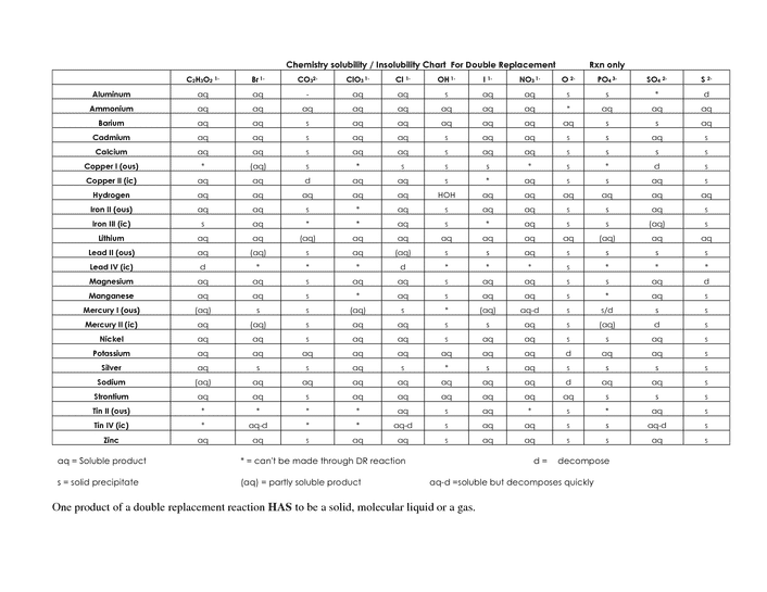

An aqueous solution of silver nitrate, AgNO3, reacts with an aqueous solution ammonium carbonate, (NH4)2CO3. What are the spectator ions for the reaction?
AgNO3 (aq) + (NH4)2CO3 ->
A 17.5 mL sample of hydrochloric acid HCl solution required 29.6 mL of 0.250M Ba(OH)2 for neutralization. The concentration of hydrocholoric acid was ____ M
Molarity = moles/volume
For the first one I wrote out what I thought the chemical reaction was
AgNO3 (aq) + (NH4)2CO3 -> AgCO3 + (NH4)2NO3, this is already balanced so separating out the ions would give Ag+ and CO32- as the spectator ions, but this isn't true. The spectator ions are actually NH4+ and NO3- and I have no clue where that comes from.
For the second all I could think of was finding the moles of Ba(OH)2 by multiplying (0.25) and 29.6 mL, but I don't even know what to do with that number.

This should help identify the first question:
OK I forgot AgCO3 was a sparingly soluble salt. I knew I was making a silly mistake. Thank you @Eclair_de_XII ..!

Goodness gracious. I am sorry. It is Ag2CO3
That's not off, but it is not what dominates the solution. Now that you know silver carbonate is sparingly soluble, can you answer the question from my previous post?
OK so Ag2CO3 is sparingly soluble. Thus its ions do not participate in the reaction. As a result, NH4+ and NO3- are the reactant species while the other two are spectators. Am I right?

That's exactly what I am trying to tell you. They don't change during the reaction, so they are not reactants, they are spectators. Actually they technically don't even form NH4NO3, they are just present as NH4+ and NO3-.
What other ions were in the solution initially? Are they still left in the solution after the reaction?
Silver and carbonate were ions before and became part of a precipitate. Now they are not part of the solution. So these are the reactants?
Yes. These are the only things that change here.
