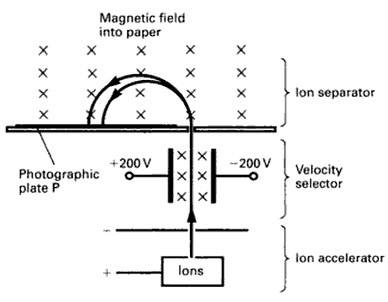

The diagram shows a mass spectrometer used for measuring the masses of isotopes. It consists of an ion generator and accelerator, a velocity selector and an ion separator, all in a vacuum.
In one experiment, tin ions, each of which carries a charge of +1.6 * 10-19 C, are produced in the ion generator and are then accelerated by a p. d. of 20 000 V. Tin has a number of isotopes, two of which are tin-118 (118Sn) and tin-120 (120Sn).
(a) (i) Assuming that an ion of tin-120 is at rest before being accelerated, show that the final speed after acceleration is 177 km s-1. Mass of nucleon = 1.7 * 10-27.
(a) (ii) What will be the final speed of an ion of tin-118?
(b) In practice all ions produced by the ion generator have a range of speeds. A velocity selector is used to isolate ions with a single speed. In the velocity selector the force produced by the electric field is balanced by that due to the magnetic field which is perpendicular to the plane of the paper.
(b) (i) The plates producing the electric field have a separation of 2.0 cm. The potentials of the plates are marked on the diagram. What is the magnitude of the force on an ion due to this electric field in the velocity selector?
(b) (ii) Write down the equation which must be satisfied if the ions are to emerge from the exit hole of the velocity selector. Define the terms in the equation.
(b) (iii) What magnetic flux density is required if ions traveling with a speed of 177 km s-1 are to be selected?
(c) After selection the ions are separated using a magnetic filed on its own, as shown in the diagram.
(c) (i) Explain why the ions move in circular paths in this region.
(c) (ii) Show that the radius of the path is directly proportional to the mass of the ion.
(c) (iii) The ions are detected using the photographic plate P. Determine the distance between the points of impact on the photographic plate of the two isotopes of tin when a magnetic flux density of 0.75 T is used in the ion separator.
Answers: (a) (ii) 179 m s-1, (b) (i) 3.2 * 10-15 N, (iii) 0.11 T, (c) (iii) 0.50 cm.

I continued the work. For (b) (i) I need to find the force.
So I used F = e E, where E = V / d so F = e V / d = 1.6 * 10-19 * 200 / 0.02 = 1.6 * 10-15 N. But the answer is two times larger. What's the reason?
Update
Maybe since the potentials are +200 and -200 we can assume that the electric field is being created by a scale of between +200, 0 and -200 or a 400 V in total. F = e V / d = 1.6 * 10-19 * 400 / 0.02 = 3.2 * 10-15 N

Though I'm now struggling with the (b) (iii) and (c) (iii) answers.
I can only think of formulas involving B like r = M v / Q B, where we don't have radius.
As I understand we need to find the radius. I used the formula above: r = M v / Q B. So we have: B = 0.75, I took 120Sn so M = 2.04 * 10-25 kg, Q = 1.6 * 10-19 C and v is 177 000 m s-1. So r = 2.04 * 10-25 * 177 000 / 1.6 * 10-19 * 0.75 = 0.3009 m or 30.09 cm. Doesn't stand even close to 0.5 cm in the answer.
That is when the ions enter the ion separator. I believe the question is asking about the selection of ions in the velocity selector. In the velocity selector, electric and magnetic forces balance each other. What is the expression describing this? You have solved a similar problem recently.
This only gives the radius of tin-120 ion. The question is asking you the distance between two impact points. What is that distance in terms of the radii of the ions?
e E = e v B?
B = E / v = (400 / 0.02) / 177 000 = 0.11299435 T = 0.11 T?

moenste said:
Hm, maybe I'm calculating wrong. Not sure.
r1 = 0.3009 m or 0.3011091 m when I use 177 123 m s-1 instead of 177 000 m s-1.
r2 = 2.006 * 10-25 * 179 000 (or 178 617.7) / 1.6 * 10-19 * 0.75 = 0.299 m (or 0.298 589 255 m).
If I use rounded values like 177k and 179k I get the difference around 0.1 cm, while if I use 177 123 m / s and 178 617.7 m / s I get 0.25 cm. But still not 0.50 cm.
What am I missing?
You are off by a factor of two. This is a big clue. See the diagram carefully. Do you want to calculate the difference between the radii?
Yes, isn't it the answer?
No. Its the difference between the diameters. See the diagram carefully.
Aaah, yes indeed! It's the difference between the diameters and not the radii. In that case we get 0.5 cm.
