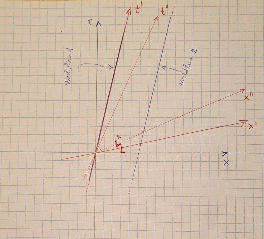

Also, the "physical distance" between the two spatial locations, of emission and reception, has to be constant (since you're only calculating it at one time, the time of emission, so you are assuming that it doesn't change). That means there must be three timelike worldlines that can all be viewed as at rest relative to each other in suitable coordinates, and physical distances along spacelike curves of constant time in those coordinates must be constant in time.
Here with "physical distance" between the two spatial locations I understand the following:
Consider the timelike worldlines of the 'things' emitting and receiving the light ray, respectively. They cross in two points (events) the spacelike surfaces of constant coordinate time ##\tau## -- in the chosen coordinate system. Then take the spacelike curve on each of these spacelike surfaces joining the points of intersection above.
The spacetime 'length' along these spacelike curves is required to be constant in coordinate time (in other words on each of the above spacelike surfaces) and it is actually the 'physical distance' we are talking about.
  • #50
cianfa72 said:
the spacelike surfaces of constant coordinate time τ -- in the chosen coordinate system. ... it is actually the 'physical distance' we are talking about.
Sure, but that quantity clearly depends on the coordinates. Calling it a “physical distance” is suspect.
Consider two comoving inertial world lines in special relativity. Consider just standard inertial coordinates. This 'physical distance' so defined, between these two bodies, can take any value in (0,L] , where L is the proper distance between them. Note, that in all such coordinates this so called physical distance is constant in coordinate time.
  • #52
Do you mean two straight worldlines having same 'velocity' in standard inertial coordinates (assuming of course flat spacetime) ?
As far as I can understand, here the point is that given a spacelike surface and taken two points (events) on it the set of spacelike curves on it joining them have a infimum 'lenght' of 0. Se for instance here
  • #53
Yes
Well, (0,L] means the interval from >0 but not including zero to L, inclusive. In any given inertial frame, the distance is constant, but different inertial frames can have any distance value in this interval.
  • #54
ok, thus I believe the scenario is the following (in blue the two worldlines):
In all inertial frames (coordinates) the 'distance' between worldlines -- as defined in the above posts-- is actually in the range (0,L]. In the inertial frame in which the two worldlines are (both) at rest that 'distance' is maximum (= proper length = L).
