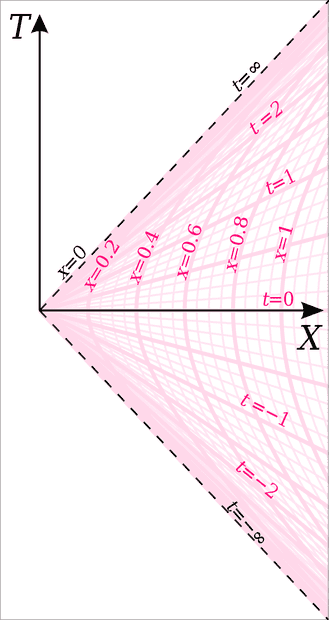

From this wiki entry Rindler coordinates I understand that the following transformation (to take it simple drop ##y,z##)
$$T = x\sinh{(\alpha t)} , X=x\cosh{(\alpha t)}$$
with ##\alpha## parameter fixed leads to the worldlines of a family of accelerating observers (bodies) each with the given proper acceleration ##\alpha##. For example the following picture (from the above link) represents the case ##\alpha=0.5##. Each observer in this family (congruence) is identified by a different value of the ##x## coordinate.
Now, if I understand correctly, the proper time of each observer (i.e. the proper time read by its wristwatch) is set to ##0## when their worldlines intersect the X axis of the Lorentzian coordinate chart. Thus if we consider for example the curve ##t=1## it intersects the observers hyperbolas in a point (an event) in which the proper time ##\tau## read by each observer's wristwatch is actually ##\tau=1##.
If the above a correct, I'm not sure if it actually makes sense to call that family of observers as "Rindler observers" since they have the same profile of proper acceleration (e.g. ##\alpha=0.5## as in the above picture).

First note we are using coordinates in which ##c = 1##.
The proper acceleration of a particle at a fixed value of ##x## is ##1 / x##. (In particular, ##\alpha## when ##x = 1 / \alpha##.)
The proper time ##\tau## and the Rindler coordinate time ##t## for a particle at a fixed value of ##x## are related by ##\text{d} \tau = \alpha x \, \text{d} t##. (In particular, ##\text{d} \tau = \text{d} t## when ##x = 1 / \alpha##.) This follows from the metric$$
\text{d} s^2=-\alpha^2 x^2 \, \text{d} t^2 + \text{d} x^2.

So, just to fix ideas, set the parameter ##\alpha=0.5## as in the wiki page. The worldline of Rindler observer described by ##x=1/0.5=2## is the worldline of the observer accelerating with proper acceleration ##0.5## (it is not shown in the above picture from wiki page).
For this Rindler observer (and for this only) we have ##\tau=t##. Then if we take for example the curve ##t=1## depicted in the inertial chart it intersects the worldline of the ##x=2## observer at the event for which its proper time ##\tau=t=1##. For all other Rindler observers their 'elapsed' proper time ##\tau## is related to the coordinate time ##t=1## (at the intersection point) through their ##x## coordinate value (i.e. their proper acceleration ##1/x##).
So basically the Rindler coordinate time ##t## in the Rindler chart is exactly the same as the proper time ##\tau## of the ##x=2## Rindler observer (not others).
Is that correct ? Thanks.

Yes.
ok, so basically the role of parameter ##\alpha## is just to select which Rindler observer is actually employed to define the coordinate time ##t## for the Rindler chart -- for example, choosing ##\alpha=1## does mean the proper time ##\tau## of Rindler observer described by ##x=1## is actually employed to define the coordinate time ##t=\tau## for the Rindler chart.
