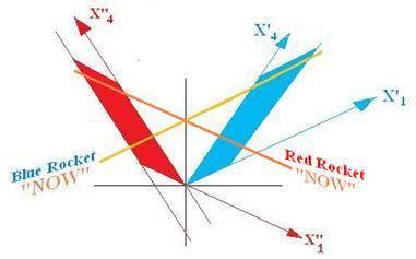

This space-time diagram attempts to indicate a 4-dimensional geometric explantion for the strange situation you're dealing with. Apologies if it just makes it more confusing. In this case we show just one of our normal 3 dimensions (X1) along with the 4th dimension (X4) of Minkowski space-time.
Here we have a red rocket and a blue rocket moving in opposite directions with respect to some black reference system. Each is moving along its own 4th dimension (world line), i.e., X4, at speed c. The strange thing that seems to happen with special relativity is that a given observer's X1 axis (one of the normal spatial directions) rotates in the 4-D universe so as to always result in photon world lines bisecting the angle between X4 and X1. Note that this is the case for the black rest system as well as the blue and red coordinate systems.
So, you see in the diagram that the blue and red guys live in two different 3-D cross-sections of the 4-D universe. Quite mysterious for sure! This of course results in different views of clocks and distances. The blue guy sees the red rocket as being shorter than his own and the red guy sees the blue rockete as being shorter than his. Red and Blue read different clock times (positions along the 4th dimension).
Space-time diagram with axes X'4 and X''4 (vertical) and X'1 and X''1 (horizontal), showing red and blue shaded rocket world lines diverging from the origin, with yellow lines and labels 'Blue Rocket NOW' and 'Red Rocket NOW'.
