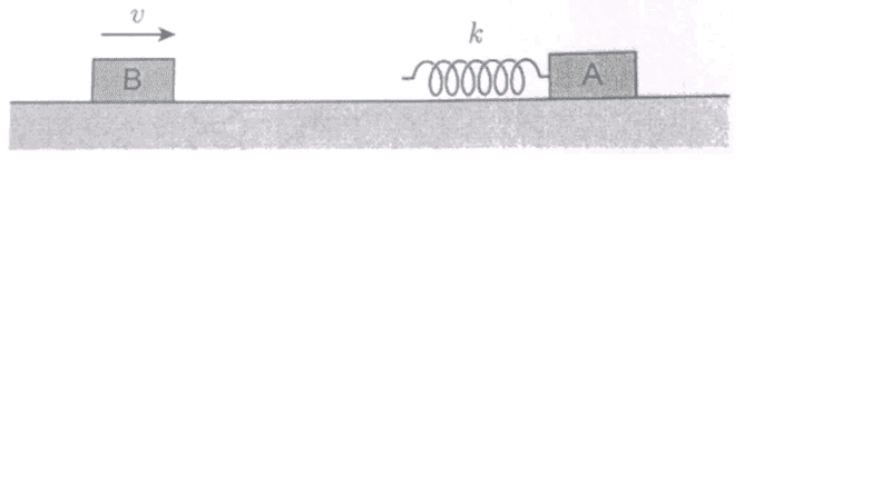

As shown in the figure below, object A (mass: m) is at rest on a smooth, horizontal surface, and a lightweight spring that compress / stretches in the horizontal direction is attached to it. Object B, which has the same mass m, approaches A from the left side with speed v and collides with the spring. The spring compresses and A begins to move. A, B, and the spring travel in a straight line. What is the speed of A when the spring is at maximum compression?
conservation of energy
momentum?
I tried using conservation of energy:
Kinetic energy of B before hitting the spring = elastic potential energy of spring at maximum compression + kinetic energy of A
But then I stuck because I don't know how to change the spring constant and maximum compression to other variables
songoku said:
But then I stuck
so consider
songoku said:
momentum?
Do the conditions for momentum conservation exist here?
Yes, taking both boxes and spring as a closed system.
At maximum compression, object A and B will move with same speed?
Using conservation of momentum:
mAuA + mBuB = (mA+mB) V
V = 1/2 v
Is this correct?
V = 1/2 v
Is this correct?
That's it.
