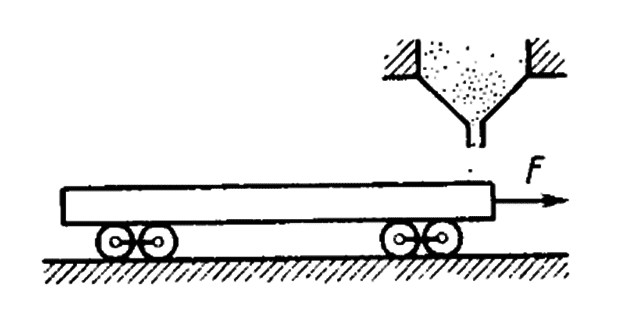

A flatcar of mass ##m_0## starts moving to the right due to a constant horizontal force F. Sand spills on the flatcar from a stationary hopper. The velocity of loading is constant and equal to ##\mu## kg/s. Find the time dependence of the velocity and acceleration of flatcar in the process of loading. The friction is negligibly small.
(Ans: ##v=Ft/(m_0(1+\mu t/m_0))##, ##a=F/(m_0(1+\mu t/m_0)^2)## )
The given question can be easily solved by the impulse momentum equation. The reason I posted the question here was to clarify a doubt about directly applying F=ma.
For the question in the thread "Sand flowing out of the car", it was suggested that it can be solved by using F=M(t)a(t) but when I try to apply it to this problem, it gives me a wrong answer. :confused:
Also, I think I was a bit lucky while applying the Impulse-Momentum equation to the problem. If the falling sand had some velocity in the horizontal direction, the answer would have been different. So how do I know when to apply Impulse-Momentum equation or F=Ma? :confused:
Any help is appreciated. Thanks!
  • Diagram of a flatcar on wheels pulled to the right by force F, with a hopper above it dropping sand onto the car.
Impulse-momentum should always work. And when mass M is constant, it is equivalent to F=Ma. So, use F=Ma when the mass is not changing.
Alternate solution: in principle, you could write an expression for the center of mass of the sand-flatcar system, which does have a fixed mass, and apply F=Ma to the CM motion.

Always apply the momentum equation, taking into account both the momentum of the loaded car (the varying-mass object) and also the momentum of the added mass. In principle, F=ma is valid only for constant mass. It comes out from the momentum equation that you get F=m(t)a when the variable mass object and the added or removed mass have the same velocity. That was valid for the leaking-out sand, but it is not true for this problem. The falling-in sand has zero horizontal velocity, while the car has velocity v. The added mass has to be accelerated to the velocity of the car, it is done by the interaction with the car and the sand in it. The added sand is accelerated by that interaction force, and the opposite force acts on the car. So it is not accelerated by F alone, but by F-μv.
Physics is not about trying equations blindly, and seeing if they give the same result as the book. You have to know at what conditions is a principle or equation valid and applying them accordingly.
If you think you can apply F=ma for this problem you did not understand what we tried to explain to you in the previous thread. Why have you not asked about your doubts?
ehild
F=ma can be applied, but that will only make the problem more complex. If you apply it to (flatcar + sand on it), you need to find the forces acting on the system. Sand falling on the flatcar exerts a force to it, because friction has to act on the sand to accelerate it until its velocity equals the velocity of the vehicle.
Really? I don't see the difficulty using it here.
Relative to the car, the incoming sand is moving with velocity -v. It therefore exerts a force -μv: ##\dot v (m_0+\mu t) = F-\mu v##. Solving that gives the desired answer.

F was meant as the external applied force acting on the car, and Pranav understood that way. The final formula can be written in the form m(t)a(t)= F(applied)+f where f=μv(t) is the term that results from the interaction between the added/removed mass and the car, and it "comes out" from the momentum-impulse equation.
You can consider the car with its load and the falling in sand separately and writing up the equation ma=F(applied) +f(interaction), but then you need to know the interaction force which is some kind of friction. The advantage of the momentum method is that you do not need to know the the interaction force in detail. It is the same as in case of collisions: You get the outcome velocities without knowing the force of interaction between the colliding objects.
Telling a student that he can apply ma=F for a variable mass system, where F was given in the problem as the applied force, is very misleading. You could see it from Pranav's question: he solved the problem with the momentum method, and then asked, why he did not get the same result from F=ma.
ehild

Instead of having the sand fall vertically into the cart, imagine it magically suspended in the air, statically, being scooped up by the cart as it moves along. The system is essentially the same. Now time-reverse it, so the sand is ejected from the cart, propelling the cart along. Apart from the exhaust speed happening to be just so as to leave the sand stationary relative to the ground, it looks exactly like a rocket.
In the sand problem, F was the applied external force: It was wrong to use the equation ma=F, m meaning the variable mass of the car and F the given external force.
It is certainly a mistake to confuse the specific F given in the question with the generic Fnet in Fnet=ma. But realize that here Fnet = F-μv and it's fine.

Thanks a lot for the explanations. I have read your posts several times, the way you have explained how to use F=ma is great. I don't think I still have any other doubts on this problem now.
Pardon for a short reply but I can't find anything to add to my post. I have understood what I did wrong while applying F=ma to this problem.
