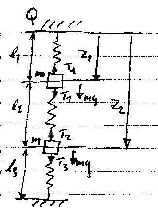

Here's another Q I'm stuck on:
"Two particles P1 and P2 of equal mass m are connected to springs as in the diagram below.
Q__
* p1
* p2
__0
The springs are identical, each having natural length l and modulus [tex]\lambda[/tex]. The fixed point Q is at a height L vertically above the fixed point O (L > 3l). Take the origin of coordinates at O and the z-axis vertically upwards and let c be the z-coordinate of the centre of mass of the particles.
The particles are in motion. Suppose that the particles remain on the z-axis throughout the motion. Show that c satisfies the equation
[tex]\ddot{c} = ( \frac {\lambda L} {2lm} - g ) - \frac { \lambda} {lm} c[/tex]
[You should assume that acceleration due to gravity, g, is constant and that the springs obey Hooke's law throughout the motion.]"

First draw free-body diagrams and find the location of c at equilibrium.
Notice that if g were 0 , c would be L/2 .
You could treat P1 + P2 + MiddleSpring as one object, but
you might want to treat P1 and P2 separately, at z1 and z2 ...
(c = (z1 + z2)/2 ; c's acceleration is the average of az1 and az2).
displace P1 from its equilibruim by dz1 , displace P2 from equilib by dz2 .
calculate the acceleration of each , then average them.
If you keep your signs straight, you'll see that MiddleSpring causes no acceleration of the center-of-mass since it pulls oppositely on P1 and P2.

The centre of mass of the system is c where [tex]c = (z_1 + z_2)/2.[/tex]
Also, [tex]2\ddot c = (\ddot z_1 + \ddot z_2)[/tex]
[tex]m\ddot z_1 =T_1 - T_2 - mg[/tex]
[tex]m\ddot z_2 = T_2 - T_3 - mg[/tex]
[tex]m(\ddot z_1 + \ddot z_2) = T_1 - T_3 - 2mg[/tex]
[tex]2m\ddot c = T_1 - T_3 - 2mg, \mbox{ putting }2\ddot c = (\ddot z_1 + \ddot z_2)[/tex]
[tex]\mbox{Expansion in Spring1: } T_1 = \frac{\lambda}{l}(l_1-l) = \frac{\lambda}{l}<br /> (-z_1 -l)\ <-- \ (z_1 \mbox{ is -ve})[/tex]
[tex]\mbox{Expansion in Spring2: } T_2 = \frac{\lambda}{l}(l_2-l) = \frac{\lambda}{l}(-(z_2 - z_1) - l)\ <-- \mbox{ don't acually need this!}[/tex]
[tex]\mbox{Expansion in Spring3: } T_3 = \frac{\lambda}{l}(l_3-l) = \frac{\lambda}{l}((-L + z_2) - l)[/tex]
[tex]T_1 - T_3 = \frac{\lambda}{l}(-z_1 - l) - \frac{\lambda}{l}((-L + z_2) - l)[/tex]
[tex]T_1 - T_3 = \frac{\lambda}{l}(-z_1 - l + L - z_2 + l)[/tex]
[tex]T_1 - T_3 = \frac{\lambda}{l}(L - (z_1 + z_2))[/tex]
[tex]T_1 - T_3 = \frac{\lambda}{l}(L - 2c)[/tex]
[tex]\mbox{Substituting for } T_1 - T_3,[/tex]
[tex]2m\ddot c = \frac{\lambda}{l}(L - 2c) - 2mg[/tex]
[tex]\ddot c = (\frac{\lambda L}{2lm} - g) - \frac{\lambda}{lm}\cdot c[/tex]
