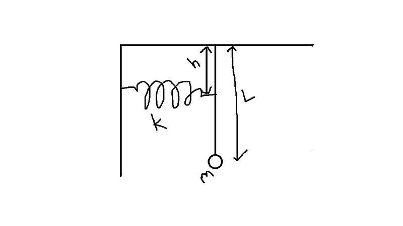

A pendulum of mass ##m## and length ##L## is connected to a spring as shown in figure. If the bob is displaced slightly from its mean position and released, it performs simple harmonic motion. What is the angular frequency of the bob?
Angular frequency for angular simple harmonic motion is given by $$\omega=\sqrt{\frac{\alpha}{\theta}}=\sqrt{\frac{K}{I}}$$
Where
##\theta=## Displaced angle
##\alpha=## Angular acceleration
##I=## Moment of inertia
##K=## Equivalent force constant
I have done the problem in the following way:
Consider a small angular displacement of ##\theta##. The torque about the the hinge at any instant is then given by $$\Gamma = -mgL\sin\theta-kxh$$ where ##x## is the displacement of the spring. But ##x=h\sin\theta## and therefore our equation becomes $$\Gamma = -mgL\sin\theta -mh^2\sin\theta$$
But ##\sin\theta \approx \theta## for small ##theta##. Therefore the torque is given by $$\Gamma = I\alpha=-mgL\theta -mh^2\theta$$ Thus we have ##\Gamma \propto -\theta##, which is the condition for angular SHM. Recalling that ##I=mL^2## we finally obtain $$\omega=\sqrt{\frac{\alpha}{\theta}} = \sqrt{\frac{K}{I}} = \sqrt{\frac{kh^2+mgL}{mL^2}}$$
Please look and tell me if there's anything wrong with the solution. Thank you.

Hello. Your work looks correct to me.
Likes Delta2
Is the bob suspended by a flexible string or a rigid rod?
In a couple of places you have mh2 instead of kh2, but that just looks like a typo in writing the post.

The equation for the torque in post #1 seems to argue that it is not a string but a rigid rod.
Yes, I think we can agree that is the intention. Posts #5 onwards have gone somewhat off topic.
The link I posted is particularly unhelpful since it does not discuss the small perturbation approximation needed for SHM, and my opinion that a string instead of a rod would be effectively the same as a double pendulum was meant to be limited to the small angle case.
Now, if it is a rigid rod, I don't see the spring remaining horizontal when the rod + bob swings through a small angle. So the extension in the spring is not just x. There is also a y component.
Small is the key. The vertical displacement is of the order of θ2, so can be ignored. It's exactly the same degree of approximation we make when we claim a simple pendulum performs SHM.
Likes Delta2
Agreed. The change in vertical component is h ( 1 - cosθ). Is the student supposed to be aware of that?
