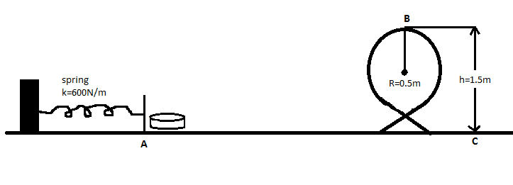

A game uses a spring launcher to shoot a puck with mass of 0.5kg along a frictionless track as shown in the diagram. The spring has a k value of 600 N/m. By how much does the spring need to be compressed to launch the puck and have it go around the inside of the loop without falling off (ignore any spin of the puck)? What is the velocity of the puck as it reaches point C?
a=v2/R
v2=gR
1/2mvo2=1/2mvB2+mgh
I could not figure out how to solve this problem. I got v=2.2m/s using the second equation.
Thats all the farther i got.
  • Diagram of a spring launcher on a frictionless track: a compressed spring labeled k=600N/m fires a puck at point A toward a vertical loop of radius R=0.5m, with top point B and height h=1.5m marked above the ground line at C.

OK. So, you have the initial speed using conservation of energy. (I'm not sure if the numerical result is correct, but if you show your calculation, I'll check.)
Now use conservation of energy again, to find the initial potential energy in the spring. You should be able to get to the answer from there.
i used v2=gR to find the v at B. then i used that in the energy conservation equation and got vo to be 5.85. and i know that the Vo=Vc, so do those numbers look right?
All looks good to me.
Now, like I said, using conservation of energy you should be able to find the compression of the spring using the information you now have.
